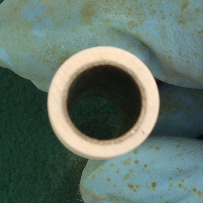

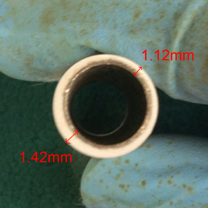

I have noticed that the section that the Nib gets pushed into is continuously off center.
View in Gallery
While at the same time the other side of the same barrel is spot on
View in Gallery
Now this seems to be happening on every pen, no matter the kit type, so I do not believe its an issue with the bushing being off center.
