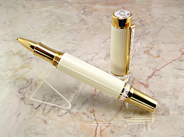

One of Berea's new Ultra Cambridge kits. Gold Ti with Sterling Silver accents. I prefer real gold to Gold Ti, but this is a very rich looking version of that plating.
They added an all metal nib coupler along with the old plastic-in-metal one. It pays to complain, I guess. Didn't want the black at the base of the centerband to mess it up, so I modified it. Can't recommend the procedure to anyone though, since I'm not sure how well the glue will hold the Casein to the Delrin.

Thanks! I'm glad you think so. I really went around in circles about what kit to put in it. The circle went something like this:
It needed to be a big pen to show off the pattern. PSI's Apollo would work well, but it's Gold Ti not Gold and, well, kind of a cheap kit (not poorly made or bad looking, but ...) This is a truly exotic material, and I didn't want just any kit in it.
I didn't think silver/ rhodium etc ... would work as the main plating, so that eliminated CS-USA's high end kits, except for their Gold Ti Gentleman's, but that plating has never looked great to me.
I finally decided to look around for some inspiration. I found these piccies. Conway Stewart - the only major penmaker that's got a Casein pen at the moment - had the aesthetics nailed, I thought. One wants gold and / or black with it.
So Berea's Ultra Cambridge met most of the criteria. The silver might be a bit of a risk, but their Sterling Silver is wonderfully bright, and I thought it would work, as long as it was just the accent material. Otherwise Conway Stewart had the look I wanted. A warm gold with the warm off-white of the casein. The silver adds a nice, "icy" contrast, I think. I would have preferred a real, heavy gold plate, but, as I mentioned, Berea's Gold Ti is quite rich.
The only problem with the Ultra was the black at the base of the centerband. Either that had to come off, or I would have to add some black segments at the ends. Doable, but then the silver would be "too much."
So that's how I arrived at this.

Now that is one of the classiest pens I have seen here. Very well done. I do have to try some of those kits. About the material you are using, ity looks fragile. Is it??? Will it stand up if droped or bumped??? Thanks for showing
John,
The material is called "casein" and it is a milk protein product. I do not recommend selling it as a "daily writer" pen.
It is water soluble (over a great deal of time, I am told) and generally is used for high-end pens. Not meant to be "thrown around".
Hope this helps.

It is a plastic made from milk protein as Ed said. Apparently, it takes a year or so of curing to make a suitable blank. The longitudinal lines and radial, "starburst," end structure emerge as the protein "crystalizes".
I am keeping it in a leather pen pouch, and as a matter of fact, just dropped it outside in the rain, on my way home. It seems okay. I'm sure the pouch helped.
I am told it stains easily, and I believe it. It is somewhat brittle, as my first attempt to part off the centerband modification demonstrated. It turns similarly to faux ivory, and cracks like it too. However, it seems very durable once you've got it into shape. I do not intend to use it as a day-to-day pen, but as a wash-your-hands-first special writer. If I start to feel really daring I may put a fountain nib on it, but there is the staining issue, so .... caveat emptor.
I'm worried about whether the CB modification will stay glued to the delrin thread insert. I think I've got a way around that for the next one, but I don't think this one can be sold.
I suppose I'll have to keep it.
