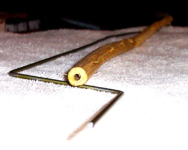

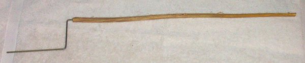

I was trying different ways to make pipe stems for a Catawba Indian friend of mine. One method was to take a suitable Black Walnut branch, make an auger from a piece of coat hanger wire and bore the pith (pun intended) out of it.
You just bend the wire as in the picture, make it long enough to pass at best through the whole length of the branch, at worst, just past half way. Hammer the working end into a flat that is about the diameter of the pith in the branch. Grind the end into a pointy shape, like the spur on a spade bit. Put the branch in your vice, and crank the coat hanger wire through the branch, it takes about 1 min. to bore out a 16" pipe stem.

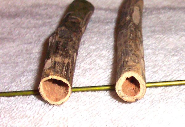

Aug 19, 2004
549
Oak Ridge, NC.
This is two Sumac stems treated the same way. The pith is larger in relation to the stem diameter and may be easier to run a two conductor electrical wire through.
