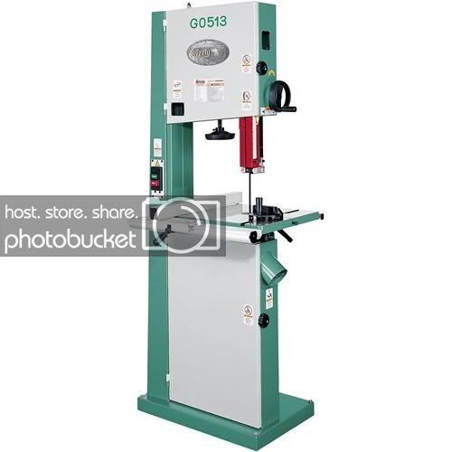

Here's my first big tool (Yup, I'm a tried and true Grizzly Man):
Here's my 2nd:
My 3rd:
and my upcoming 4th:
With these all, I'll be making coffee tables and other living room furniture from exotic veneers and solid exotics.

If you are buying a Grizz bandsaw (which is fine) PLEASE opt for the biggest motor you can afford. I've used 3 Grizzly bandsaws and EVERY ONE of them seem to be grotesquely underpowered. I also used a Laguna 20"(ish) bandsaw that would power through anything and not bat an eye at it.
If you are looking at the 17" Grizzly, try to get the one with the 5hp motor, you will NOT be disappointed.
One of the reasons is that a higher power bandsaw will help your blades last longer--- the reason being heat.
A wimp motor will bog down easily and build up a lot of heat on the blade--- -they way heat dissipates on a bandsaw is "chip removal"--- literally, (to a great degree) the rate of which the sawdust is cut and removed will also determine how quickly the blade cools from the friction.
Slower speeds (bogged down motors) only remove chips (and heat) slowly. A more powerful motor removes them much quicker.
Ask anyone who runs a CNC router like they are supposed to---- running the router bits too slow will quickly heat them up and ruin the carbide. I could only expect the same to be true with a bandsaw. I know that with the Laguna we used those blades a LOT and rarely changed them. With the Grizzly we have to change them much more frequently and we don't use them as much as the other shop used the Laguna.
Redfishsc,
First of all, I love your quotes. The one by Elliot is my favorite, but The Rabbi's is also pretty awesome. Secondly, I must have lucked out. I broke my first band saw 1" blade pretty quickly and had it welded by a friend. He had no experience with saw blades, so it broke again rather quickly. I bought a carbide blade, for a hundred and a half bucks and have been beating it up for about two and a half years (about two months after I bought my 17"). I do bog down with it, but it's been a great saw. I'm sure that the Laguna would spoil me though.
