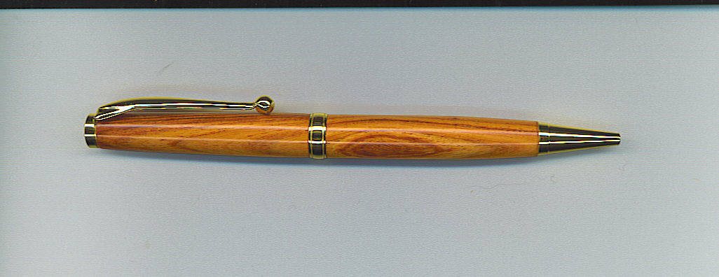

I have been trying my best to do a decent CA finish. My first one came out terrible. Dull spots and it seems the CA magnifies any little scratches that are still on the blank. Second one came out better. I did notice scratches that seemed to be deep, not even sure where they came from. I am thinking something got in between the sandpaper and the blank. The scratch was almost diagonal. The third one didn't make it on the kit. I got my best finish yet, I think, but one side of the pen WOULD NOT come off the mandrel. I tried even soaking it in acetone. Didn't work. I ended up paring off the wood and getting off the brass tube with a lot of work. I hope I didnt ruin the mandrel.
All and all I see there is a lot of potential for me with this finish. I get more shine with the CA, but it has a different feel than the friction polishes. As a long time woodworker, I think I prefer the shellac, but I cannot argue with the shine and durability of CA. I can see why customers would prefer that. A couple of things popped into my mind as I was using the CA. For the first time while gluing the blanks, the CA got cloudy and almost looked like there was a film on it. The CA is about 6 months old and is kept in my basement. Temp is between 65 and 70, but it has been damp down there. The bond seemed to be real strong as I was trying to get the blank off the mandrel though. Could it just be too old? I used a different bottle for the finish. My second question is, is it normal for the paper towel you apply the thin CA to start smoking while I put on the first coat? it got so hot, it melted the baggy I was using on top my fingers.
I scanned a picture and hopefully the picture will be sharp enough for anyone to take a look and give me some pointers. I tried to take a picture, but the pictures came out fuzzy for some reason.

Those few scratches for me was caused by applying a little too much pressure during sanding with the coarser grits. I cured that (for me) by applying less pressure and spending a few extra seconds with lighter pressure on each successive grit.
The dull spots is usually where the CA has been fine sanded off. Building up a few more layers of CA should fix that.
Sticking bushings and mandrels: One thing that has been recommended often is to wax the bushing and mandrell each time. This has helped me tremendously. Rifleman suggested once to use the bushing to turn and sand to size, then place a home made piece of plastic washer from a butter dish or tupperware type of dish (don't let the Mrs. see that) - place this between the bushing and turned blank. I have done this a few times, particularly on a few expensive pens. It sure helped me.
All of the above has increased the amount of time it takes me to finish a pen by 10 to 30 minutes. But it is worth it.
Though I don't use CA finishes any more it was one time my finish of choice. I have experienced many of the frustrations that have and came up with possible theories and solutions.
In regards to the scratching,while they may have come from the coarser grits my guess is they came from the original tooling and were hidden by the sanding residue.Try blowing the blank off between grits.Do this between every grit before proceeding to the next.
About the cloudy spots.If you are like me you are anxious to see what the finish product will be. It took me a while to determine that the heat generated by the turning/finishing process may be causing the problem.I believe the cloudiness(especially under a CA finish) stems from the fact the mandrel adapter, mandrel and the blank itself gets warm.Once the Ca is applied the moisture in the blank gets hermetically sealed under the CA.Try letting the blank sit and cool off after sanding and before applying the CA.
Sometimes these ghosts will appear regardless and there is very little you can do to get rid of them.
Lastly get another mandrel set up or two and work on more than one pen at a time.
I have learned that most of my problems stem from being impatient waitng to go from one step to the next.
With more than one pen going at a time I find that I am not in a rush for things to "cure" and when the blank is cool the results improve.

Thanks Lee, After I sealed the wood and MM I used two coats of thin CA and two coats of thick CA. If and when I get those dull spots, I will try and put another few coats of CA and give that a go. I have been my second CA finish pen at work now since yesterday, it does have a scratch on it, but the shine is holding up. I ordered a few kits from Dario's group buy and I wanted to be able to put a halfway decent finish on them.
Gary

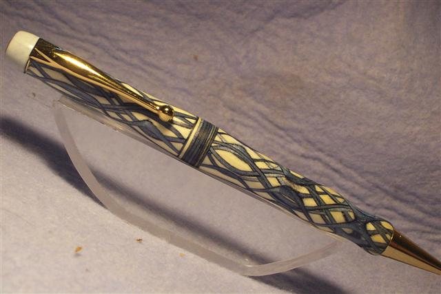

I don't care to add BLO to the process after seeing how it changed the color of a pen I intended to be blue and white.
Straight CA is about as clear as it gets showing only the colors of the wood beneath it.
(Note the color change of the white backround wood in the center of the lower section)

Eagle, do you think that the color change might be from the wood being softer in that area?
Nope.

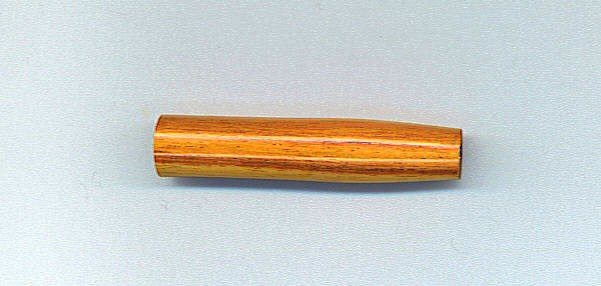

As I look at the pen in person I has other areas of amber color in them. a few are visible in this picure, other than the on I pointed out.
