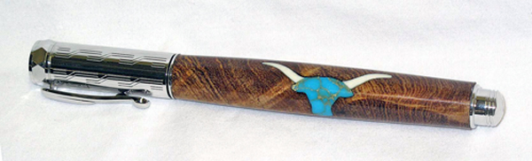

I am making two pens from AS - see pic...
I just finished epoxying them up then came in and saw this thread at the top of my page...
It was a toss up (in my mind) before I saw this thread about CA vs 5 min Epoxy...
So I guess I did the right thing...
Since I'm in Austin, the Longhorn has to be UT Orange...so I'm beginning to lay in InLace tomorrow morning...my first attempt with InLace...!!!
Any suggestions...?
