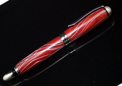

Yes. Epoxy or CA.
<br />
Eagle-ized blank in aluminum and bloodwood.
Go slowly and watch out for sanding dust. Wear eye, nose and mouth protection.
That's almost exactly what I had in mind Lou. If I could get that to work, I was going to try for a tree look with branches being done in silver on a dark wood, possibly something dyed dark green.
