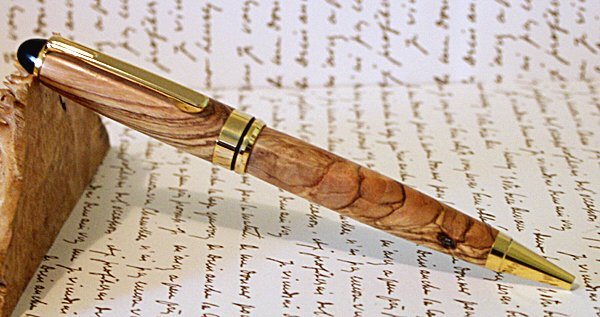

Ken, I have done a bunch of BOW burls that had voids in them as I turned to size... I don't try to fill with sanding CA into the voids... I stop the lathe prior to final dimension and then drip medium CA into the void and give it a light spray of mild accellerator.. I do this to each void.. the CA will be proud of the void and you can take a light cut with your skew to bring it and the wood to final dimension...
Avoids CA burns and other nasty surprises... the CA will almost always blend into the color of the voids unless they are really big in which case I use some BOW sanding dust as a filler first.
There were 2 voids in this pen... one is fairly obvious (at least to a penturner, the customer never knew it)... the other isn't
Usually apply Ca with the lathe off for filling but have done it at slow speed with the lathe on.
The trick is knowing whether to use thin, medium, thick or gel CA.[;)]
