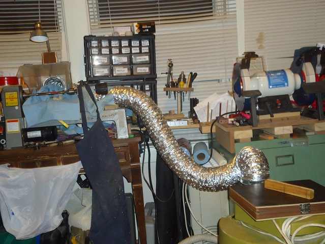

Thanks all. I'm going to build an evac. system. Gallon jug with the bottom cut out and a small shop vac.
Well, I have decided that I got a reaction to the CA fumes. I thought I had a sinus infection or was getting the flu. I have since built a home made extraction system and I have a NIOSH P95 respirator, I will try it again and see what luck I have but I'm very aware
now and if I have to Ill give up CA, It was several days of misery. Thank you all for your advice and suggestions. Im also going to try alternative finishes. But right now Im waiting for some wood to arrive.
What finish do you folks use instead of CA? I really like the CA look but this winter the hazard may not be worth the effect. I have used friction polish but it didn't give me that really shiny finish I like. I went to the library and read the MSDS for CA, so now I am looking for serious alternatives.
When I started turning I had the same problem the first time I used CA, flu-like symptoms that lasted a day or two. My shop has poor ventilation. I took a 1 gallon milk jug and attached it to my shop vac as a dust collector and that was enough to pull the ca fumes away from me and solved the problem. It also worked great for collection sanding dust. Now , years later, I have a proper DC and air filtration along with a proper mask.
