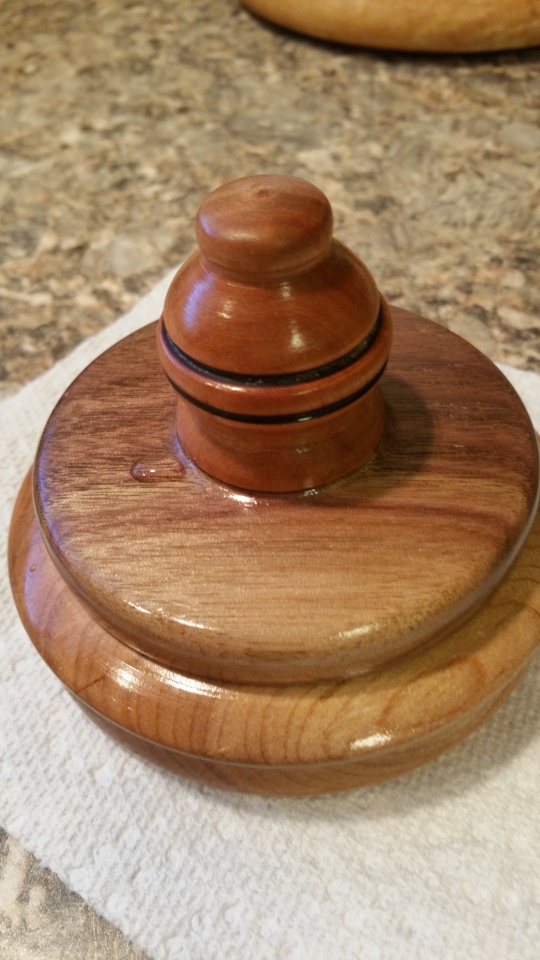

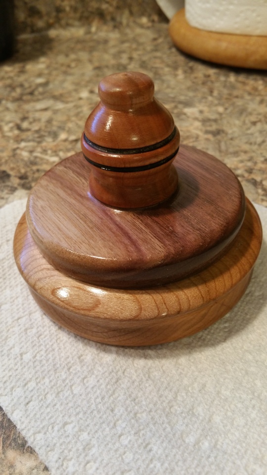

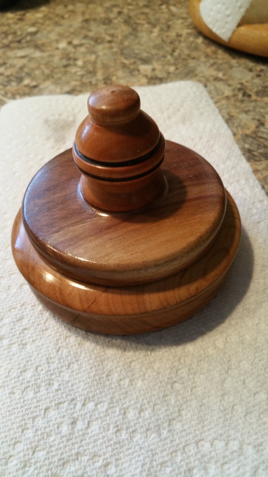

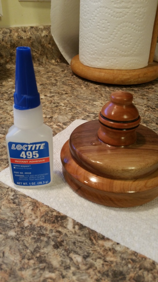

All I do is turn the speed of the lathe on about 800 rpm,,,the bottle does not say either which thickness it is, ,,I put some on a white paper towel and with the lathe running put it on,,and I give it about 5 secones to dry,,turn the lathe off to see if there is a nice even coat on it with no buildup like ca glue,,which there never is,,,then repeat the process for each coat,,,,and no I do not use accelerator,,I guess you could if you wish,,,and I DO NOT SAND PERIOD,,,and the results are truly amazing,,,,I'm at work and can't upload a picture I took of a lid I turned yesterday but when I get home I will upload it and you be the judge,,
I'm anxious to try this! I was just at Home Depot, but they didn't have any unfortunately.
these are the pictures I took,,notice the droplet of water,,this has 2 coats
