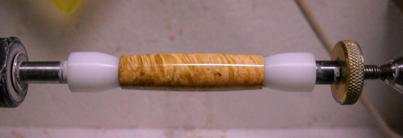

I turn and sand between centers using johnnycnc's steel bushings but I still prefer to use his Eliminator bushings on a mandrel to apply a CA finish:
http://penturnersproducts.com/index.php?main_page=index&cPath=2_15

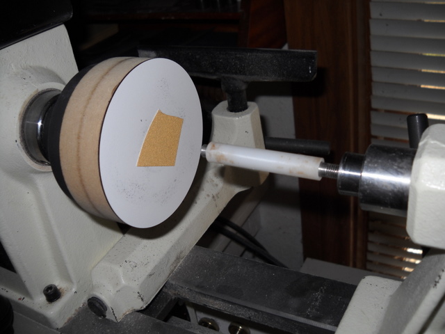

Excess CA does accumulate on end of the blank but I sand off the excess on the lathe using a MDF faceplate. I keep the blank square with milling sleeves on a shortened #2 MT pen mandrel n the tailstock. No problems with chipped CA finishes or stuck bushings since converting to this procedure. I use a skew to clean the CA from the Eliminator bushings after I'm done.
Again, TBC for all significant material removal and mandrel / Eliminator bushings only for CA application & polishing.
