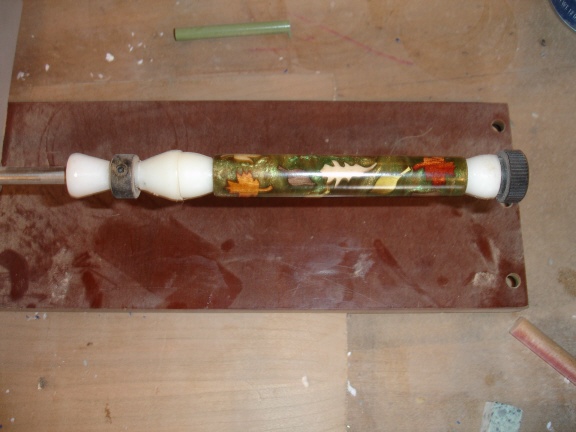

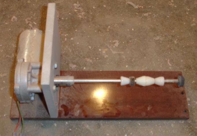

Here is what I use for my urushi finishes. Rod dryers are the way to go if you are spraying. Set up an array of these and you won't need to worry about CA any more.
http://www.acidrod.com/images/dryer.JPG
This is the array I'm building right now.
http://www.acidrod.com/images/rdm4.jpg
That will be a sweeeet setup Chris. I'm not to familiar with the rod turning equipment. I am not doing production either, but with my little rotisserie shown here, I can spray a multitude of pens in a day if I want. I only have to spray 3 coats to get a good thick finish and the finish dries very fast. I can knock out 3 coats in an hour, then slide the pen off the rod onto a dowel to cure over night, then wet sand and polish just like any finish. I put newspaper under my rotator so it doesn't get all messed up. I did not build this, it was made by someone here, but I am not saying who, because I don't know that he wants a ton of customers since he is busy already. My finish is a real finish, not a glue, so it moves with the wood and I've never had one fog up down the road due to heat, oil or moisture, nor does the finish ever crack from movement of the wood because the finish is super hard, yet flexible being that it is engineered to be a finish. CA is a non-flexible adhesive and nowhere on it does it recommend being used as a finish. Not saying don't use CA, I'm just saying that there are better stronger finishes than CA that require far less work, perform far better and cost a heck of a lot less. Who pays $5 for one ounce of finish!
Acrylic finishes can take some really serious abuse, that's why so many people use them on their kitchens. The are not water based finishes, nor are the pre-catalysed, but they can be called pre-catalysed, and they are cleaned up by using water. Acrylic finishes are more of a urethane finish suspended in water. Nobody really seems to know what to call them. What people do know is they are the shizbomb!
oh..one more thing. My rotiserie is an A mandrel. I bought delrin pre-drilled bushings from Joe Colazzo. I spun the bushings to look like corks. As a cork shape, they are able to hold any size pen withough needing to ever switch bushings, and no finish overlaps the pens to the bushings because of how they are made, so you don't need to cut the bushings from the pen to avoid damaging the finish. You just use a mill sander prior to assembly.
I do not wish to argue what is better, CA, or other. I'm just stating my opinion, which is part opinion, part experience and part fact.:biggrin:

I think a multistage rod turning system would be great, I wonder if the current rod varnishes would adhere to wood that has been wiped with BLO after the oil had dried for a week or so?
I have a machine controller that can handle up to 6 servo or stepper motors , but my system board only handles 4, I think I'm going to build a single unit and see if I like it, I still want to present the best possible finish to a pen that represents my name, and I really had let some junk through, What difference does it make between a slimline and an Imperial or Emperor ?? What difference, either pen carries my name, SO I still don't think THE perfect finish for all applications has come round yet.
Nice dryer Jeff. It's pretty much the same thing I have. My rods are a little longer so I can put a bunch of finished blanks on them and with the chuck I can change out the rods to sit on a drying rack after the finish has set for a few hours and won't sag. Also, the chuck is nice for swaping in and out closed end shafts. CA still is my standard "quicky" finish but I am slowly moving away from it.
Whatever the merits of the argument, the fact is CA is an acrylic finish since Cyanoacrylate (CA) is an acrylic resin.
As to the not-so-veiled suggestion :wink: that you give something of lesser quality and durability (Do your customers use their pens for chiseling granite?) when you give a pen with a CA finish: Time may tell differently, but I still have one of my earliest pens; it has great CA finish, and three years later, it still looks great. So for now, I don't buy it.
As I said, time may tell differently, but I use CA because I think it is best - by my definition of best. It is quicker, not too messy, and given the amounts used, the greater cost isn't all that big a deal. I love the mirror deep, high gloss "wet" shine I get with it. If I find something better, I will use it. But better means different things to different people. As Thomas Sowell has said, "there are no solutions; only trade-offs." If I had weeks to do a pen, I might familiarize myself with the longer curing finishes, and make a go of them. I do not have weeks. So I make the trade off.
