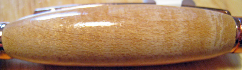

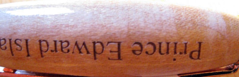

ok.. showed some pens to a guy last night, then was looking through the case today, (I always keep the case partly open ever since the last post thinking I need to let the gasses out)
One that was NOT fogged over yesterday made out of 10 year old maple and lasered in june is now fogged over heavy today!!:confused:
Pen stats:
Made in June and lasered in June. Stored inside always and in a dry location. Was NOT fogged over last night but is today? :confused:
My Method:
Shop is in a dry basement. Depending on the wood, wipe down with Acetone. Hit with a few coats of thin CA, either let spin dry or dry with accelerator when its near dry, then use Meguiar's plastx polish to shine.
This is making me want to give up on CA completely, but its such a nice finish (when it works lol)
Any suggestions on what would be doing this?
