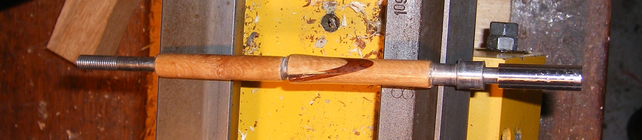

I have an interesting problemette with a CA finish. This is my 7th pen with CA finish. Never seen this problem before. The damn blank got glued to the mandrel!!
I had to remove it with a hammer and a hacksaw. Made a terrible mess of my first inlay / segment pen. It's beech wood with a diagonal mahogany stripe.

Glued to the madrel usually means ca in the tube. Even dried ca in the tube will soften during the heat of turning/sanding and then once cooled again, as you found out. Go get a

Ken; Take some wax to your mandrel and bushings. Coat the mandrel and bushings, even inside the hole in the bushings. You should not have any problems after that. I use a tapered delrin rod mounted on the mandrel with a size "D" hole in it.
