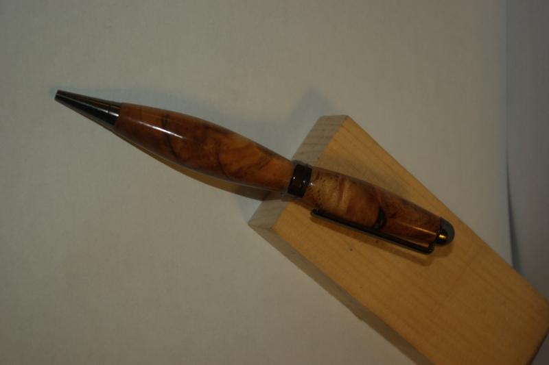

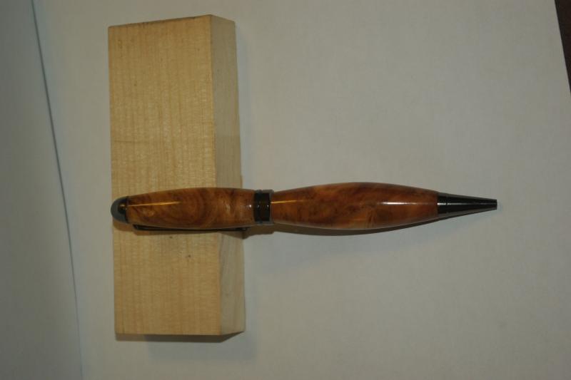

Came out OK
Thanks for the help, my son and I took your advise and used sanding sealer then 10 coats of thin CA.
