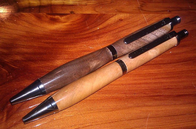

Success!
Success!
I took all the advice, and went back to trying the CA finish again. It worked!
I used the polyester batting as advised by Russ Fairfield; I ended up with a super-rough texture, probably because I was using the same spot on the batting multiple times (hardened with previous CA coats). But, I was able to sand down the high spots, starting with 400 grit, then 600, then micromesh.
I think the key for me was wet-sanding with the micromesh. Previously I've dry sanded with it, and the results weren't fantastic. Wet-sanding, though - it's a whole different story! Faster, easier, less messy, and the CA finish takes on that glassy look...
Here's a couple of pens I turned with the new technique. Excited to keep improving on it!
Lee
