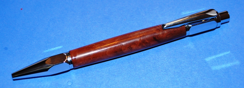

I have one pen that has been driving me nuts..
I've re finished it twice and it keeps doing the same thing..
It's Madrone burl..
First time I finished it with 1 coat thin CA then 3 thick.. sanded up to 600 grit One end turned out dull so I thought maybe I'd snaded through the CA so I re applied 3 more coats thick CA then snaded it back to 600 and buffed with sipral and loose cotton wheels.
It was looking all glossy from end to end but when I went to assemble it half the pen was dull again..
2nd refinish I sanded it with 600 to an even sheen then put on 4 coats thin then buffed it to a high gloss.. I did a 2nd Purplehart at the same time.. same finish same CA..
The Purplehart kept it's gloss but the Burl was showing dull patches again 12 hours later..
What the heck is going on?

The CA may be reacting with the oil in the burl. Try 1-2 coats of BLO prior to the CA. You can search the forum for CA clouding for other ideas.
You say you sanded back to 600 grit??? What did you start with?? I bet you sanded through the CA. It does not take much. After you apply CA you should never have to go that low on the grit scale. Should be micromesh from there. Need to relook at your method. That is my opinion.

"Sand through" is the most common cause. However, there are a few root causes behind this. If using a mandrel and flex is introduced during turning; if the bushings are off center, (happens more than one would think); if the tail stock or the dead center/live center do not line up; of if using a non-60° live center in a mandrel - ALL of these can cause some "off center" turnings by about .005 to .007 or more. Then one side will get more sanding than the other and dull spots occur.
Sometimes, adding old BLO, or using some bad CA cause some dulling. But most of the time it is simply "sand through".
I use calipers and measure the turned, sanded and prepared blank before adding CA. Then I add CA and measure the build up. I also measure the CA as I sand it back down to size.
In doing this (using calipers) I know the size of the blank and the size of the nib/centerband/clip end. And, I know how much CA thickness I should add and build up to be able to sand back down to the level of the nib/CB/clip.
