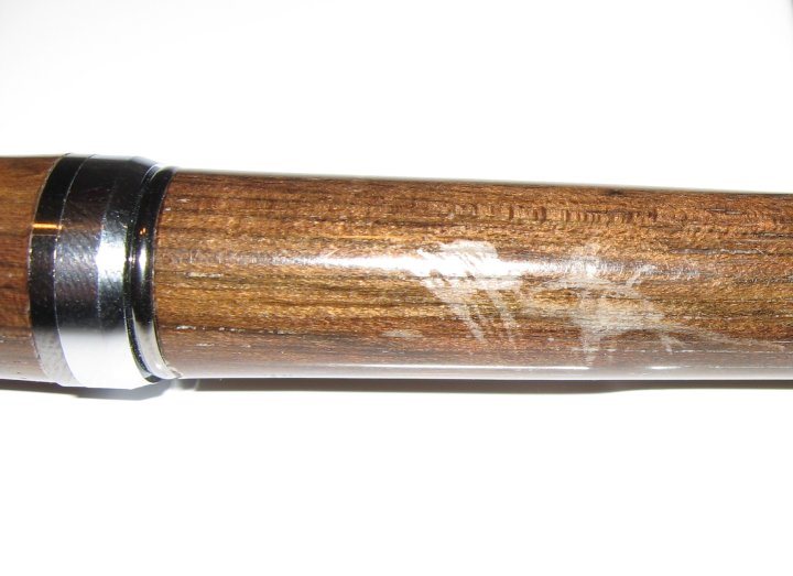

I was looking at a pen I did a couple of weeks ago with a CA finish. In a couple of spots it looks like the CA finish is seperating from the wood. There are a couple of small circles about the size of a pin head that look like there are going to grow bigger.
Anyone else have this issue?
I did use DNA to clean the blank before using CA. I don't know what kind of wood it was, but I posted it here and most felt it was either Walnut, Wenge or Mahogany.
Last night I did an experiment and took some pictures for you folks to see.
I decided to use my fingernail and scratch the CA finish. The first scratch seemed to break the bond between the wood and the finish. Subsequent scratches ended up removing the finish and getting down to bare wood.
My question is do you think it was to thin of a finish? I thought the CA finish was one of the most durable finishes, maybe I just did it wrong on this pen but I did give a few away for Christmas and now I'm worried.

DNA didn't evaporate before you applied your CA. Looks like you didn't had a good bond. Had the same things happen to me before.
I don't use DNA to clean my barrel now, switched to CA accelerator instead and no problem since.
I guess it was probably the DNA. But how come it took a month to get like this? I figured all this would have happened right away.
I would consider eliminating the DNA from your process. Compressed air does as good or better in cleaning the blank before appplying a finish. DNA adds the potential for problems due to the fact that it has a lot of chemical "junk" added to it to make it unfit for human consumption. There is no recipe, so each manufacturer wings it. There are other reasons not to use DNA which are better explained on Russ Fairfield's and Michael Dresdner's websites.
