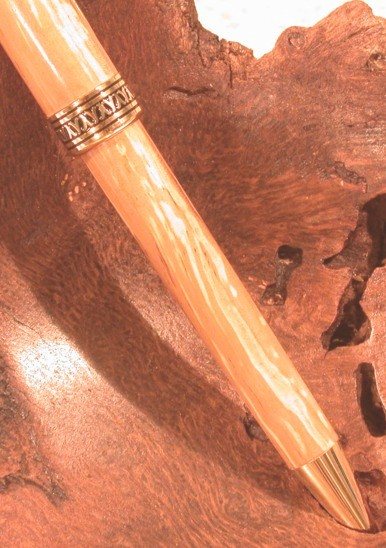

I'm beginning to wonder if I sanded thru the CA now, or if certain parts of the wood absorbed more of the CA. The wood is spalted Apple and it seems as though the gloss/dull transition lines appear where the wood changes colors. It's possible I just needed to add more coats of CA before calling it done.

The problem you're describing with your apple sounds like you might be using heart and sapwood together ("where the wood changes color"); is that the case?

I didn't try that. What would that do?
Here's a poor picture of the spalting...
<br />

At this point we are just guessing as to what is going wrong.
There are just to many answers to this question without have the wood in hand.

I have had similar issues and tried a few different ways of fixing it. The spalt can absorb CA, oil, or whatever at a different rate than other parts of the wood. On pens, I use thin CA first to seal the wood then move to thick, which works most of the time. Other times I use Mylands sanding sealer and that works in some cases too. Sometimes just sanding it all down and going through the process again work wonders.
But the biggest improvement I made (thanks to Lou) was to let all coats of CA sit, at least, overnight before any sanding or other finish was applied. It takes a lot longer but my finishing has improved greatly with that change.
