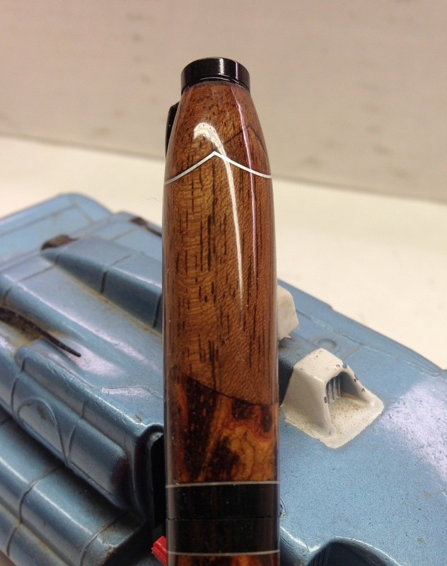

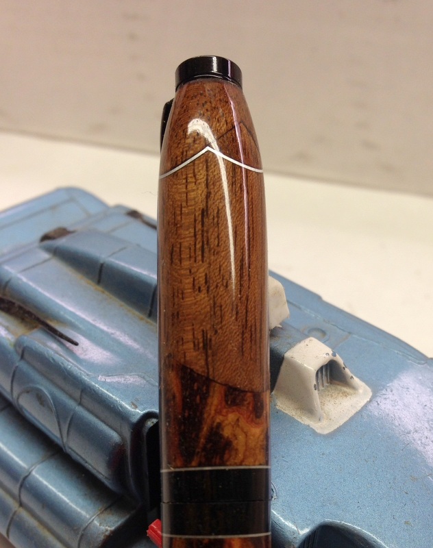

In the meantime, I tried a straight CA finish and ended up with this on a dyed poplar stabilized blank:
I have to say that I now see why it is such a popular finish and I also see the appeal of a simpler method along the lines of using BLO. Finger's crossed it stays this way and doesn't crack on me. Three days so far!

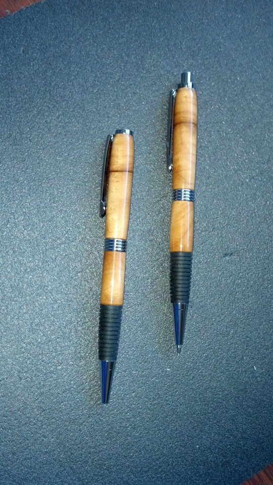

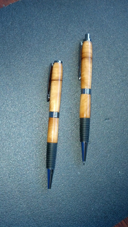

CA-BLO finish
The pen shown is cross cut walnut from the same plank. I used BLO only on the bare wood to bring out the grain and then 20 coats of medium CA. Occasionally I get some pits with white spots in them. It takes time, the CA is tacky even with accelerator. If you go to heavy with the accelerator it boils the CA.
On another pen I did the CA-BLO thing (8 coats) and wound up with a finish that was not shiney but a little on the satin side. Still looked nice but I had to practice on a couple scrap blanks to get it right then make sure I did exactly the same process on each pen or the results would not turn out very well.
Trial and error I would guess. Takes patience and practice, and lots of free time in my case. I dont use fancy hardware either. Too much bling takes away from what I would like to see in my pens.
A word on cross cutting blanks, I found the turning to be somewhat a delicate touch and the sanding very easy being the grains are turning at you instead of left to right. Very different finish IMO.

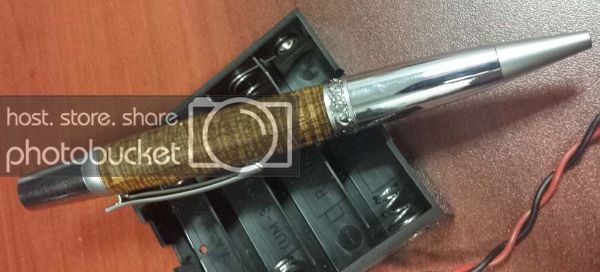

This is my daily beater pen that I made about a year ago out of curly Koa. Use it at work daily and it has held up well. Really impressed with how durable the CA finish has been...Not the best picture as it was taken with my phone
