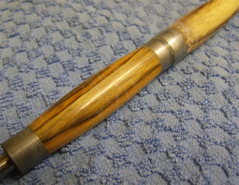

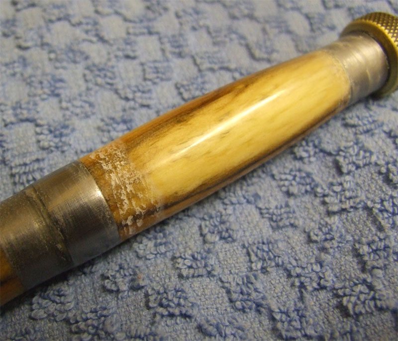

Hi,
Ive been trying to master the CA/BLO for a few months now.Have tried both the Russ method and the method of the video shown on YouTube recently!
Now i have had relative success, but its taking me up to 5 times of resanding and reapplication before i get a consistent result and the gloss and smooth in the finish is not really up to par!
Many of my attempts end with a lot of white specs or a slight hazing of white in the finish. they are not cloudy, more chipped looking, but smooth too the touch! Any ideas?
Ive been applying 4 coats of medium CA per blank, 3-4 drops per coats.
The CA is new and so is the BLO, and using paper towels! MM to 12000 before an after CA.
This is the latest attempt, now unless i completely sand this back down to the wood and start again, the problem seems to stay to persist, like the CA doesn't attract to the previous coats!
Really im just speculating, as i don't have a clue! Im thinking maybe not smooth enough coast of CA? Or i need to apply more in order to get them smooth before MM of the finish? Have a look at the pics, any ideas are welcome!
The wood is English Yew by the way! But problem is with anything i've tried yet!
Cheers PHIL
Phil,
I'm far from an expert but I will offer opinions on what I can.
The white specs sound like sanding dust that has been trapped under a coat of CA. The find particles gets trapped in tiny voids and show up extremely well after the CA is applied. :(
Many blow the blank off using an air compressor. Some wipe it with DNA, although that carries with it the possibility of not evaporating and causing moisture blooms or clouds under the CA.
The blank in the first picture looks like scratches that weren't removed using the side to side method. They may or may not have held dust when the CA coat was applied.
I can't even begin to guess on the second picture, unless that was a whole lot of sanding dust. I really doubt that though.
Best of luck. We'll see what the real CA experts say.
i'd agree with mark about it being dust being trapped. have you considered trying ca by itself? it will kinda fill itself in sometimes and eliminate some of those things. but nothing beats careful, careful sanding, which i'm sure you're already doing... i personally never liked using BLO with CA, so i switched to CA on its own, i feel it provides a better finish. it might not go on as quick, but i like spending a little time finishing the pens... build up a nice thick coat of CA so you can sand it smooth and then use your usual polishing routine.
I noticed that for me, I get the whites like you have in the picture - when the lathe speed is too fast. CA sanding dust builds up on the sandpaper or MM, gets hot and melts back into the other surfaced CA. When I slow down, or used two or three second swipes, or keep the SP/MM clean, I keep that from happening.
I find that I can remove it by taking a minute or two and sanding long ways by hand to "rub" sand it off. I can also remove that by using the lathe on the slower/slowest speed and fresh sandpaper.
Im no pro at ca finishes and sometimes I have this problem when I press to hard and edges of the paper towel stick to the glue. Ive had to sand it off and start again. I also use a lower mico mesh sheet to take off any ridges or lines in the glue in between coats and wipe the blanks with a clean rag before each coat. Like the posts above I turn the lathe down a bit.

After having a look at the blanks again I think that i have had a rough finish to the CA in those area before i have started polishing. This combined with not wanting to sand through the finish has meant that the final surface is not 100% smooth or void free! So the surface defects have filled up with CA dust thats just been trapped the finer in the MM i get!
So im thinking, add a thicker coat of CA or more coats, giving me the chance while im not 100% sure of how to get a smooth coat, to sand down to a even and void free CA before final polishing?
What speed are you applying the CA? What speed are you sanding? I found that I was using a speed that was way to fast. The results were that the CA would start to gum up and looked very much like your bottom picture. Try using a slow speed like 500 RPM to apply the CA keeping a wet edge as you work across the blank. Once it is applied slowly move from side to side until you get that great smell. That is when I let it sit for a few seconds and switch to sanding with a light touch moving the paper because it will start to gum up on the paper. Then repeat. It worked for me. Might be worth a try.
