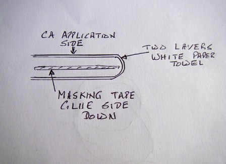

I have tried this applcator for CA finish without getting my fingers burnt and stuck. Uses less CA since there are only two layers of paper towel.
