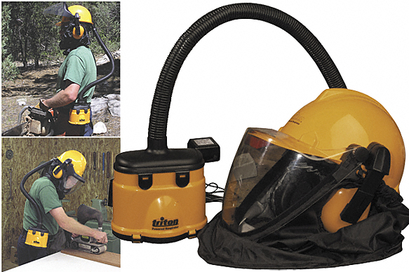

Anyone use this Triton orange lumberjack outfit below?
I use it when sanding bowls, but for CA you'd have to be careful where you mount the belt pack, as it may pick up the CA fumes and blow them into your helmet. Also, never use this helmet after having bean burritos for dinner. DAMHIKT...
