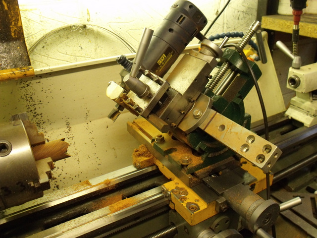

My golden rules on deciding on what lathe to buy are;
1. Metric
2. Change gears, not gearbox
3. Large hollow bore headstock spindle ( Min MT3 )
and most important of all...
4. The longest bed you can afford.
You never know what you'll eventually want to bolt on to it:wink:
Mine is a 10 x 21.5 and it is often too short for some of the pen stuff I make.
