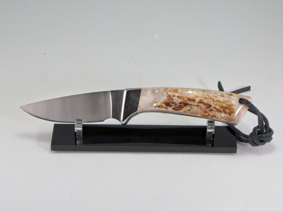

Got a request from a church friend for a high end knife to be used as a gift…??? But M…. I don't make knives I make pens. He wanted me to make a knife using some antler the "gift-ee" had gotten from a recent hunt. The blade blank(Damascus steel) was going to be ~$100 or so. I told him I thought I could do it but I needed to practice on a less expensive blank first so He said "make me one". So now I have two knives to make. I bought what is called a "kit" knife for practice. Turned out it wasn't that "inexpensive" either. I have ~$75 tied up in this one. It was called a kit on the website where I bought it, it included the SS blade blank but the "accessories" were sold separately. To include two "rough-cut" SS bolsters and two SS pens. Unlike our pen "kits" the knife maker has to work some of the components as well as supply/work the "accessories, the handle and and handle retention pens. So here is the "practice" one, what do you think.

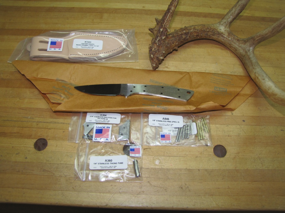

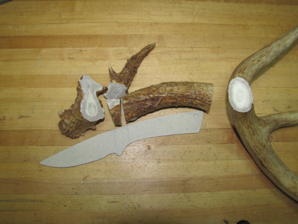

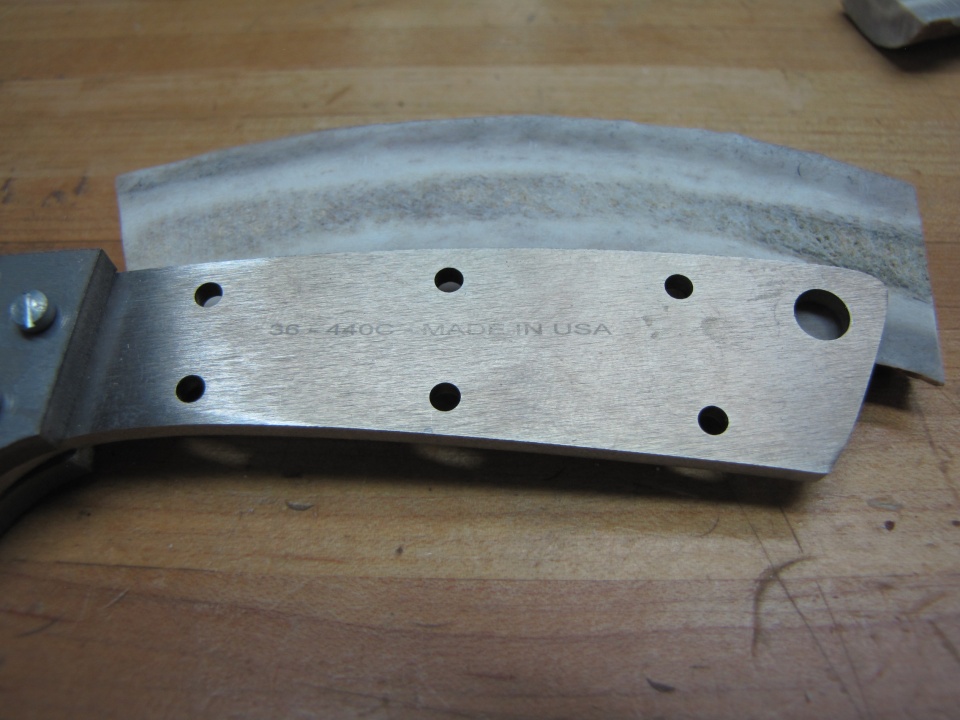

The "kit" include only the blade, I had to supply everything else. At least everything was American made.

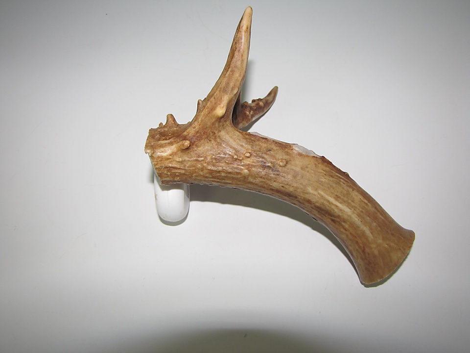

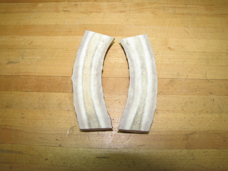

I first cut a section out of the antler to match the handle area.

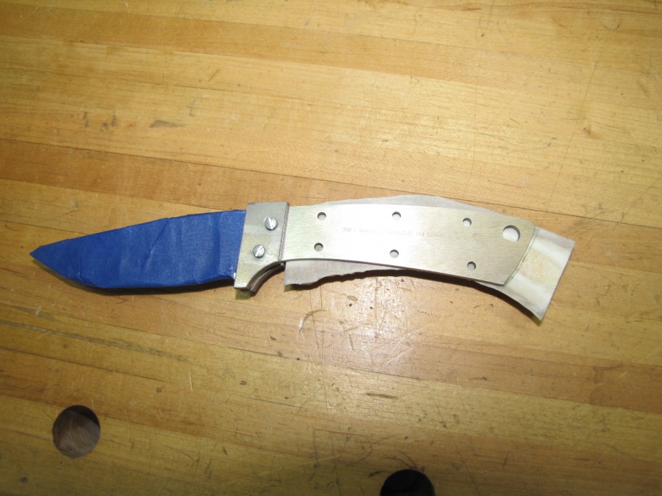

Then split it and fitted the "scales" to the blade handle.

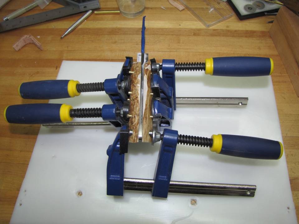

After drilling and pinning the scales and test fitting everything was epoxied together.

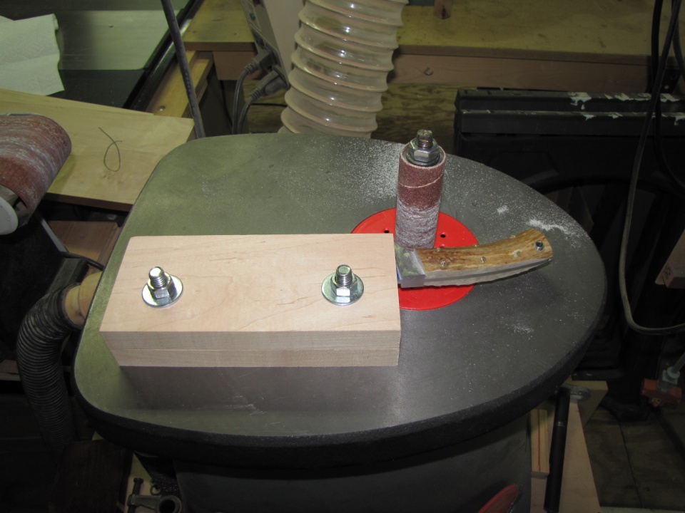

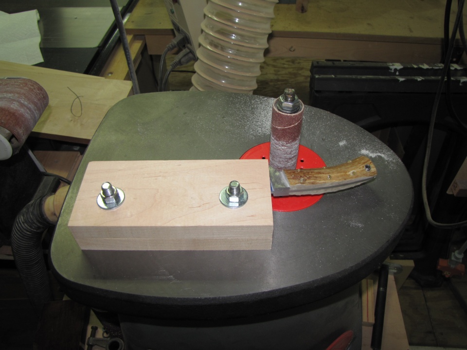

When the glue was cured I used my oscillating sander and shaped the handles to the blade. Had to make a holding clamp the keep the blade at right angles to the sanding drum.

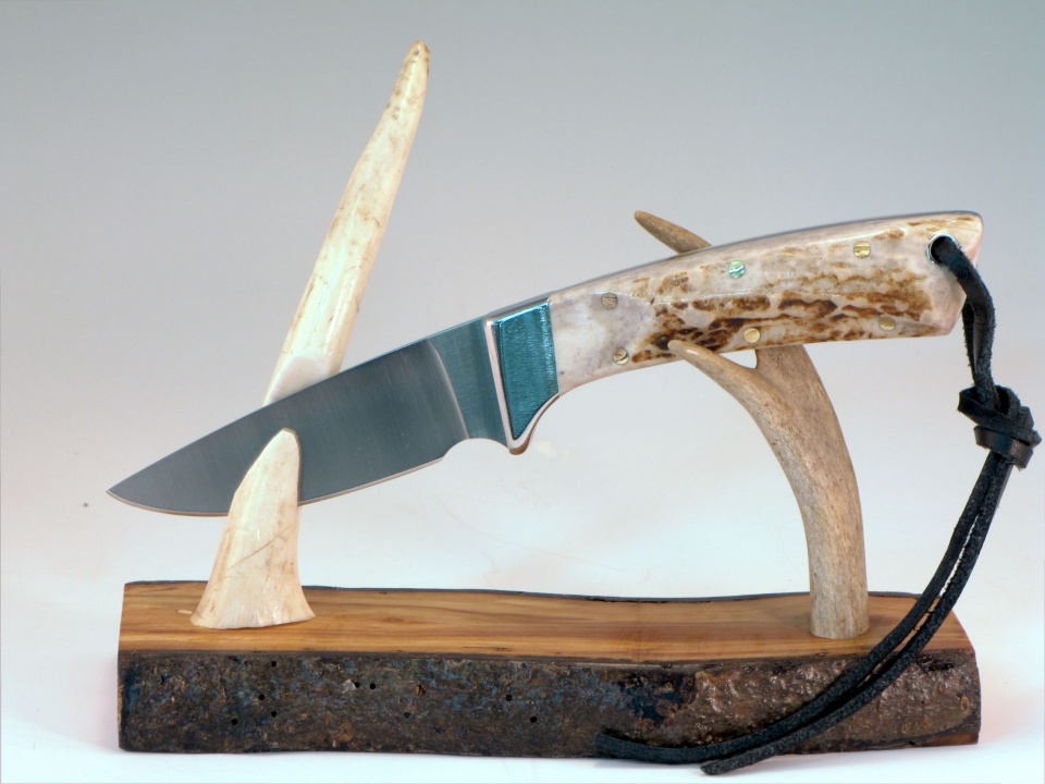

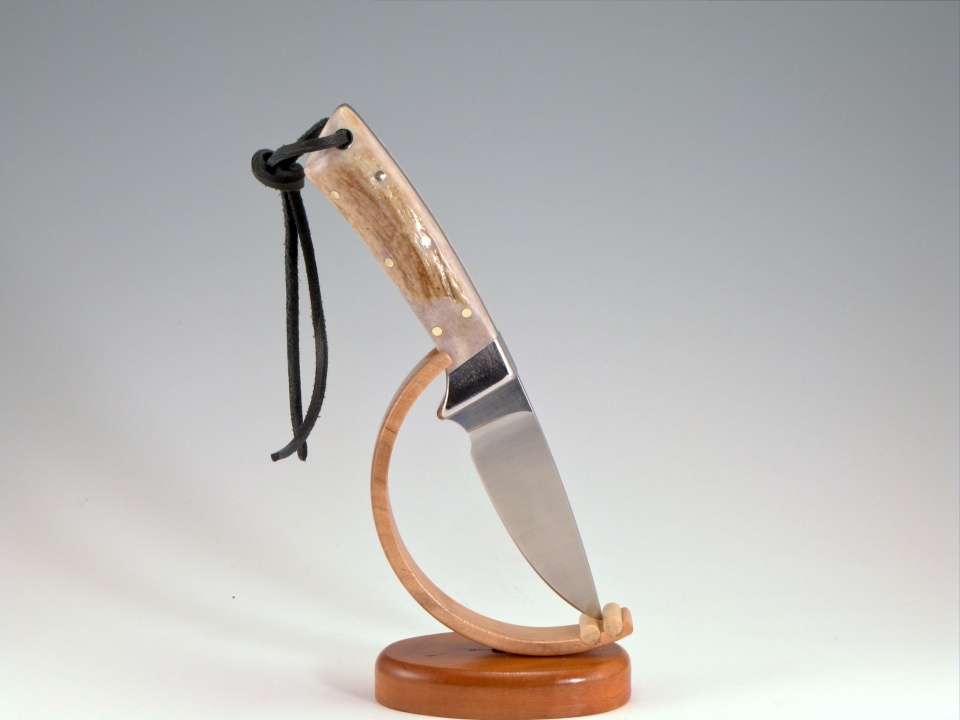

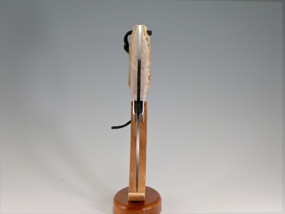

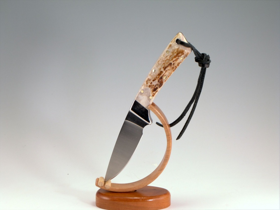

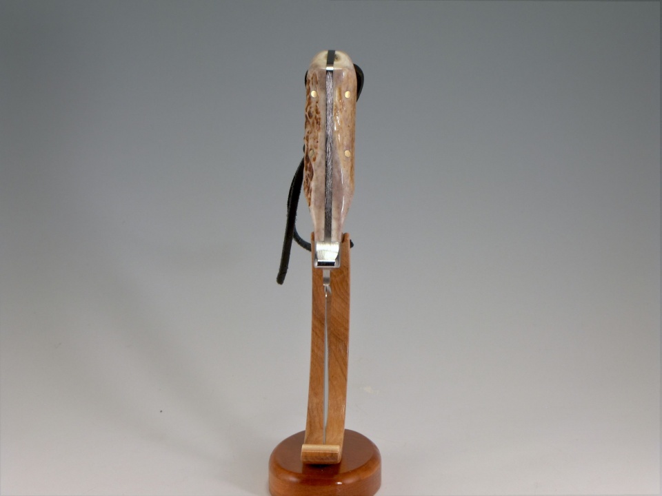

After a lot of shaping, sanding, and buffing this is how it turned out. I haven't shown it but the sheath was wet-ted and shaped to the knife profile as well. I want to dye it a little before pics.
From the suppliers website:
440C Stainless Steel Satin Finish
Overall length: 7-5/8"
Blade length: 3"
Blade width: 1"
Blade Thickness: 1/8"
Bolster Holes: 1/8"
Handle Holes: 1/8"
Thong Hole: 1/4"
HRC57-58
ACCESSORIES SOLD SEPARATELY

C&C appreciated.
