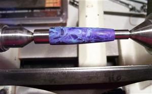

Typical use is a 60 degree dead center in the headstock and a 60 degree live center in the tailstock.
Place appropriate bushings small ends into tube ends, making sure they are seated to the shoulder (larger diameter step)
and snug between 60 degree centers on your lathe. Do not turn the lathe on without sufficient pressure to drive the blank, if the centers are spinning loose from the bushings damage to bushings/centers will likely result.
