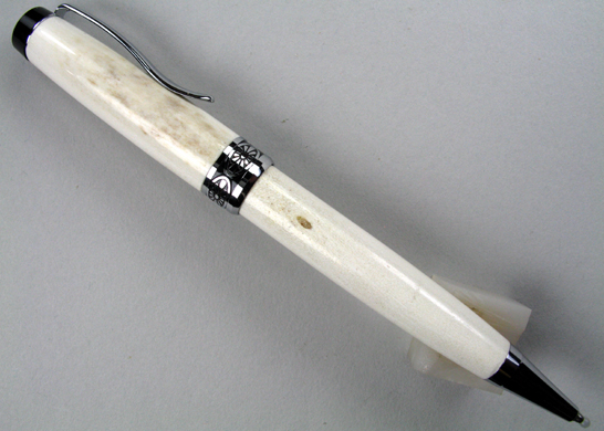

The thinking was that antler being a natural material, a natural flaw wouldn't look out of place. Wrong, after finishing (CA to seal), buffing and assembly, it was too obvious.

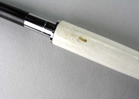

Used a dental pick to remove any CA that was in the hole.

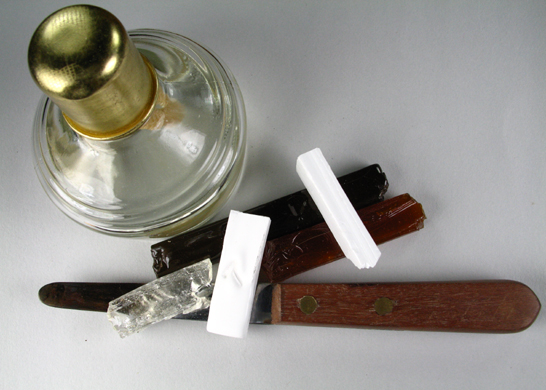

Filled the hole with white Burn-In stick. Easy and quick repair, just heat a pallet knife, melt on a touch of the shellac stick and fill the hole. I used the white stick, it was a little too white but closer than the open wound. Many colours are available to match wood repairs.

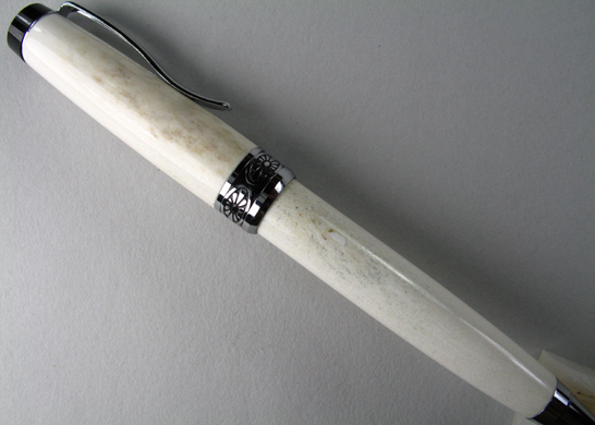

The finished pen after a little sanding and repolishing. The repair is still visible but a definite improvement. If you didn't know I'd been there you probably wouldn't even notice.
A old trick from the furniture repair trades. Works better on wood, easier to match the exact colour.
