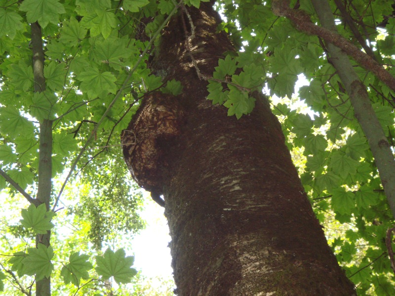

Attached are a couple pictures of a burl on a tree I saw when out walking in a local park.

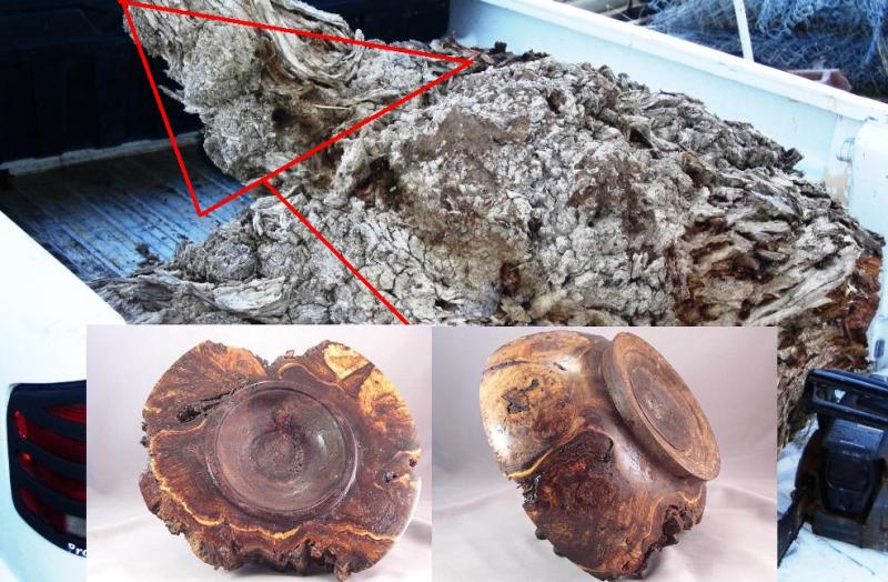

This is a couple of shots of a Mesquite burl that I found, it was formed due to mistletoe attacking the tree. In the second photo the bowl came from the area out lined in red. GOOD LUCK with your hunting. :smile:
Too bad you couldn't carry a chainsaw out there and save that tree? At least that is what you should tell the officers while your trimming that thing off!
