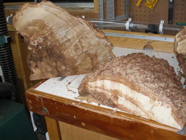

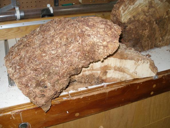

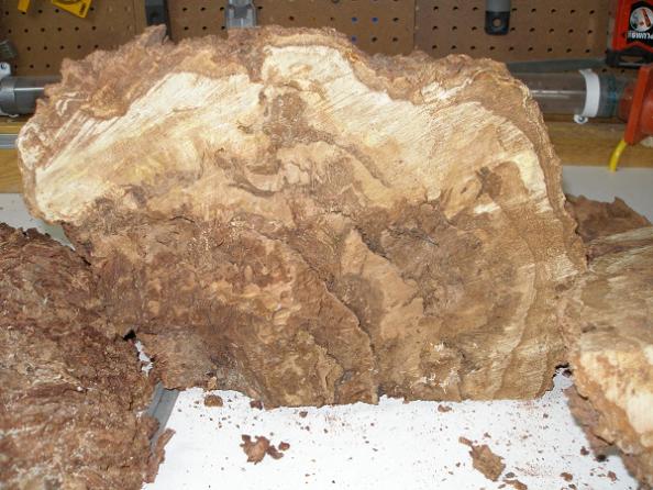

I cut a big a__ eucalyptus today and found this on the side of the lower trunk. I shaved off two big slabs and home they came. I believe this would be burl, am I correct.
Now a couple of questions. Is burling usually,,,,sort of soft and almost rotten feeling? Its also pretty light.
Here is a few shots of the raw slab. Approx 5" thick.

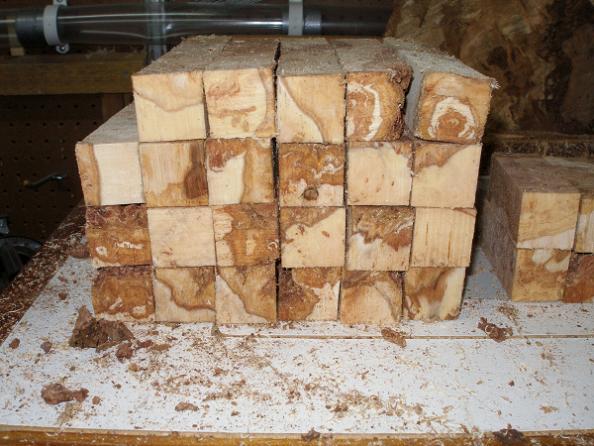

Here are some of the blanks I cut from one of the slabs. They are 1 1/4" x 6". Some of the smaller cut offs are 3" and a few are misc lengths.

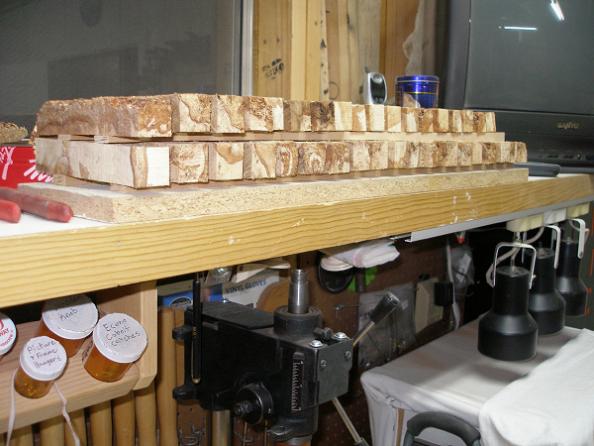

This is what I did to set them up to dry. Rows with stickers in between.
What do you think of the patterns in the end grains? Speaking of end grain, this is my first totally green/wet wood find. What can I do to help them dry more evenly, using fairly household products? I'm afraid I wouldn't have time to order something to treat the ends.
Maybe candle wax? Or paraffin? (i know it's wax, but it's pure and non-colored)
Any help would be apriciated.
Just send it all to me and I will dry it for you.. Kidding aside, I don't know much about drying wood, it will need to be stabilized, but I have heard putting wax on the ends does help keep it form checking.
What are the different items under your work bench, the black items? What is in the prescription bottles
Steve, I have used candle wax / paraffin wax. Don't go too thick or it will want to flake off. I still have those branch bits in my shop you sent me done like this. I have an old camp fire coffee pot that I keep my wax in. Throw it on the BBQ and let it heat up. Dunk one end at a time and let them dry. Paraffin is cheap by the box and I just toss 1/2 used candles in the pot inbetween "cookings"

The black things are three of the five lights for my light tent I use for pen photography. The pill bottles contain small items such as small hinges, screws clasps and the such. Items I don't want to put too far away or I will loose them.

By the way, when you dip them, go half an inch or so up the sides too.

I cut them 1" sq and about 6" long, stack them as you have shown and let them dry. I never coat the ends. Any end checking can be removed when you size the blanks later. These small pieces will dry pretty fast at room temp. You could set them on top of your heat ducts to hurry the process.

I get a lot of green/wet wood from friends, after I cut it into blanks, I let them sit for a day or two (depends on how hot the weather is), drill the tube holes, and then I put them in the microwave on defrost (defrost is very impotant) for 28 seconds at a time. I usually do this four or five times, usually after the fourth time I don't see any more moisture on the surface, run the drill through the holes again, and then glue in the tubes, this helps keep them from warping. I've only had one crack on me and that was one of the first ones I did.
Wax prevents wood from drying out too fast. When you put wax on the ends, that is for wood that the end grain is on the end. The water will exit the end grain first and most of the water will wick out the end grain. When the wood dries too fast, especially on the end grain, this is the point of checking or cracks.
On a burl, the grain could be anywhere, so as it dries (if too fast), it will split at that point. On burls if you don't stabilize or rapid dry with a pentacryl or something like that, it could crack or check anywhere. I prefer to wax the WHOLE blank and let it slowly dry over a long time (several years). It will still dry, but much slower.
