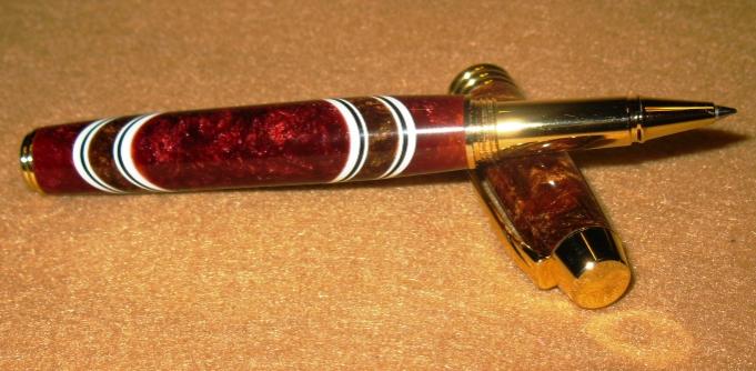

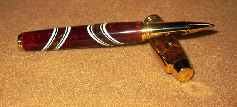

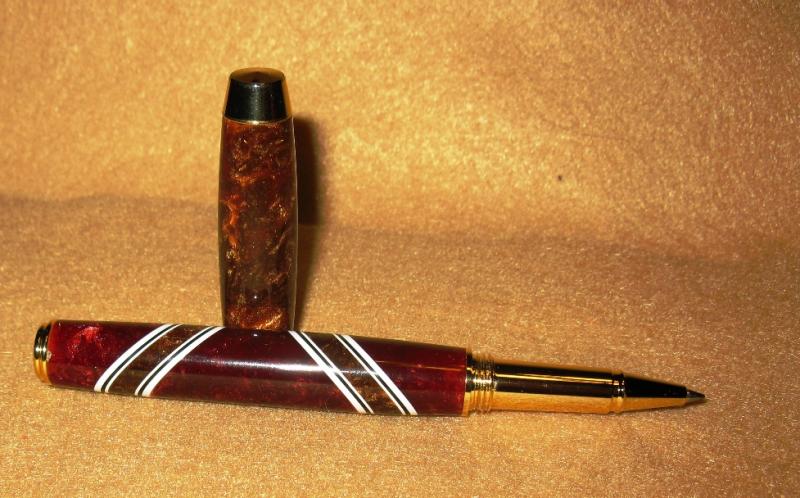

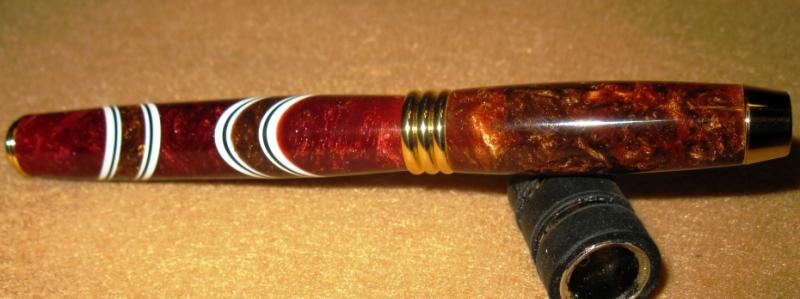

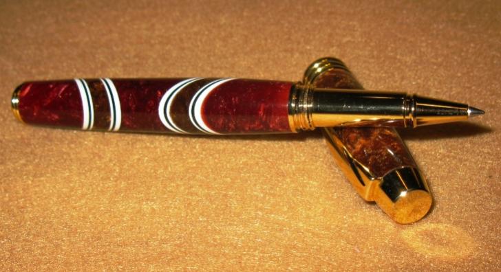

I used two Blanks from Exotic Blanks for this one, Burgundy wine and Bronze. The Burgundy Lower half is segmented with pieces from the Bronze and W/B/W pick guard, the upper half is just Bronze.
Any comments Welcome! Thanks for looking. :biggrin::biggrin:

Gorgeous! Do you mind telling me what you used to glue them and what angle you made your cuts?
I used thick CA with accelerate and the angle is 45 degrees, On the full size blank I made the inside pickguard almost touch so as I turned it down they moved apart.
Nice design and great looking execution. The burgundy and bronze look similar enough that they seem to belong together, but different enough to create a subtle design element.
