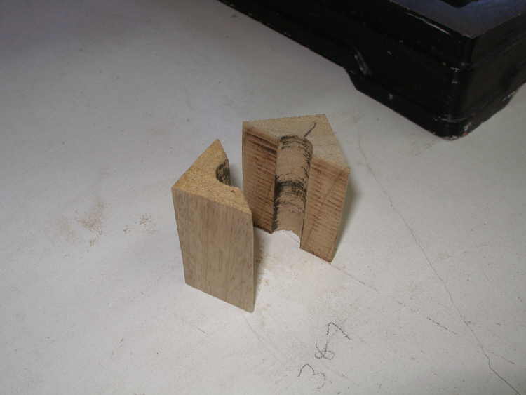

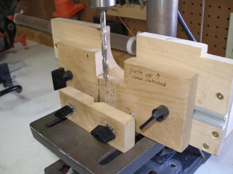

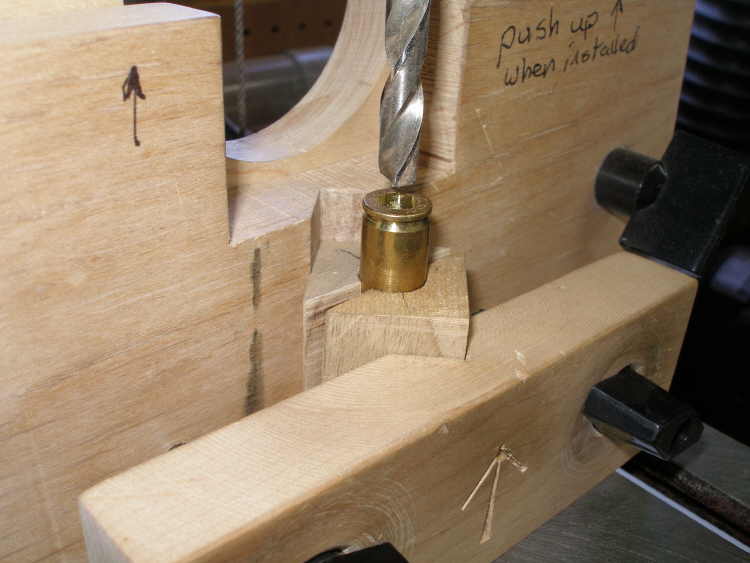

Nothing fancy but here what I use to drill casings . Originally threw it together to do my first casings with intentions of coming up with something better. That was over 350 casings ago. I figure now, if it works don't fix it. Drill slow, light to medium pressure, and I use a bit lubricant for when brass warms up it can get grabby and it helps to keep the bit sharp.

I use a large spot drill to start the hole. I do this because the primer is still in the casing and I need to overcome the firing pin indent. During the spot drilling the primer is drilled out and it creates a chamfer. I then go in the the final size drill. I set the speed and feed it I get a continuous ribbon off the drill bit.
