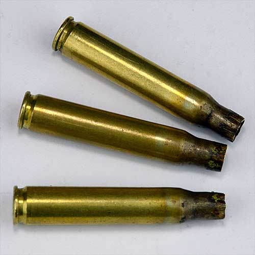

Marty -- I have the casings from my fathers honors. The casings were blanks with the neck of the case crimped. The crimps needed to be swaged out with a reloading press. I happened to have that and had dies for the casings. I got about 6 and of those 4 were recoverable. Two of them had the case necks break (metal fatigue) at the crimps. Once the necks were straightened, you could still see the lines from the crimp (good from my perspective) -
You should be able to find a reloader to help you out closer to Georgia than I am, but I can do that for you.
Once deprimed and with the neck open, you choices include polish and clear coat or just use as is with tarnish and all (what I did).

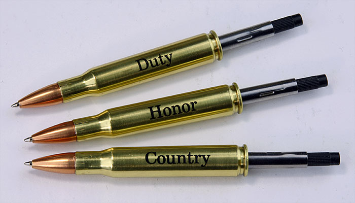

The kits
Here are a couple of teaser photos. The first is of the fired blanks. These ones are 30-06 caliber, and you can see the crimp marks in the case mouths. The second pic is of the completed kits. I look forward to seeing the finished pens.
Regards,
Eric
They Look Good so far, I also look forward to seeing the finished pens.
