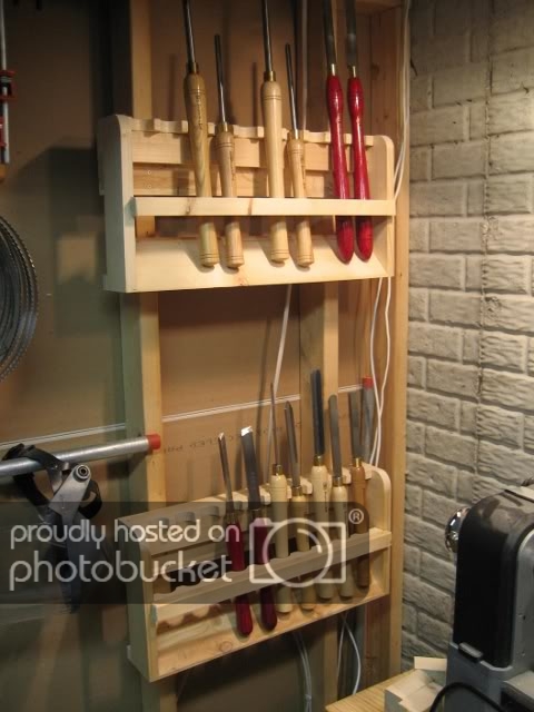

I built my own tool holders and hung them on adjacent wall 2x4 studs using cleats next to the lathe. The cleats enable quick pick up and move of the whole tool holder which can be repositioned to sit on any flat surface. I got the tool holder idea from another wood forum.

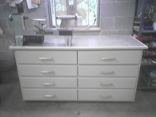

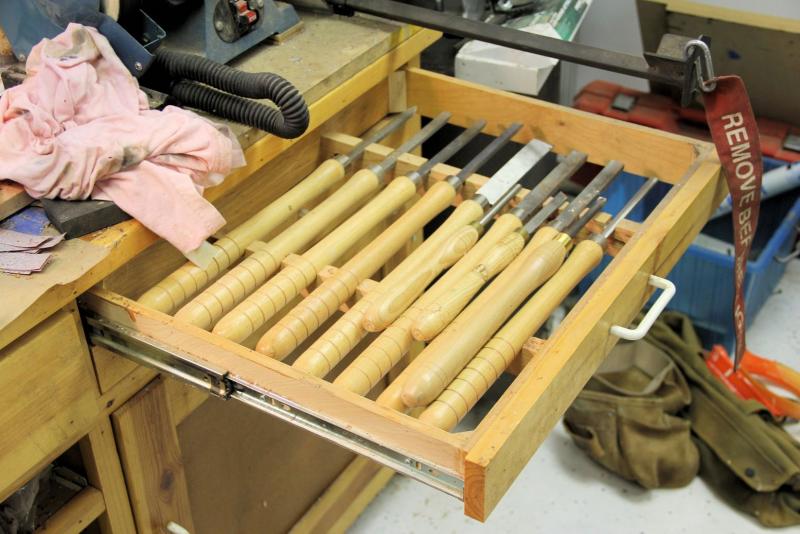

My set-up. Top 20"x58", 33" tall. I sized the unit for my 6'0" height. Left side is a top drawer for all manner of things, with three (3) open pull out trays which is my primary blank storage.
Right side has two tool storage drawers. They are on full-extension slides and sport a feature I like a lot - No Bottom. Thus when the chips are flying they don't accumulate in the drawer, but head straight to the floor.
Cabinet below those drawers hides lots of stuff.
Entire unit is on casters so I can move it around, but this is mostly for that occassional cleaning.

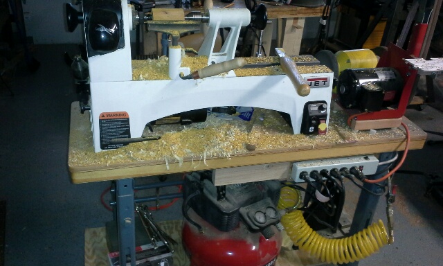

I made my stand from TJI type joist cut offs. The top is the perfect width for my Grizzly midi to set inside the rails. I built a 4' extension on the right side for the tools, sharpener, on grinder. For the tools, I drilled 12 holes with a 1" Forstner bit. I also put 2 4 gang plugin boxes under it. It's Hillbilly all the way.
I had a nice 24 by 54 by 1 1/2 top on my last table and I left it behind in Japan. I used a Rikon 12 in lathe.

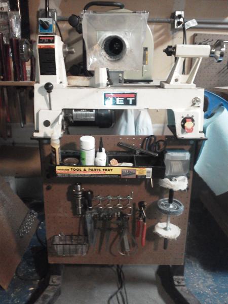

I went cheap and easy on mine. One sheet of 2' by 2' pegboard (1/8" thick, 1/8" holes) and a few assorted pieces of pegboard hardware. Mounted directly to the legs of my lathe stand using the lag screws that hold the stand at height.
Andrew

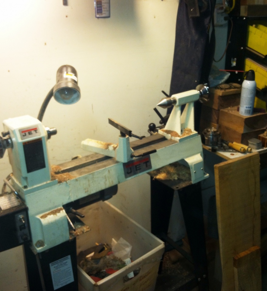

My Jet 1221vs is on a industrial sewing machine stand. They adjust many ways and are made of heavy metal. I have several and have been happy with the way I can custom fit to each machine
