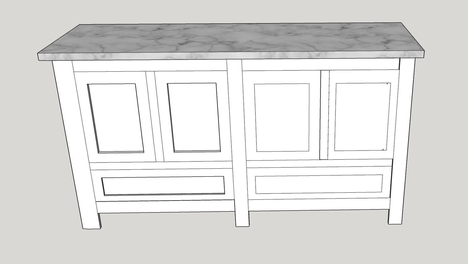

Had the same concerns about limitations of store-bought vanities (limited sizes, flimsy materials) and built one a couple of years back (rough Sketchup below). It was fairly straightforward and only required a few basic tools: Table saw, track saw for breaking down ply (circ saw with jig also works), drill, etc. Shaker style doors meant no router needed.
Upsides: Can customize dimensions and design any which way you choose, including more robust materials than store-bought. Plywood construction gives peace of mind in case water gets where it shouldn't.
Downsides: Ended up being more costly than expected--countertop was 2x cost of all other materials combined, which was a surprise. Getting square cuts on larger ply panels can be tricky without the right tools/jigs.
Ditto on the previous recommendation for videos--lots of in-depth tutorials on cabinet/vanity construction on YouTube.

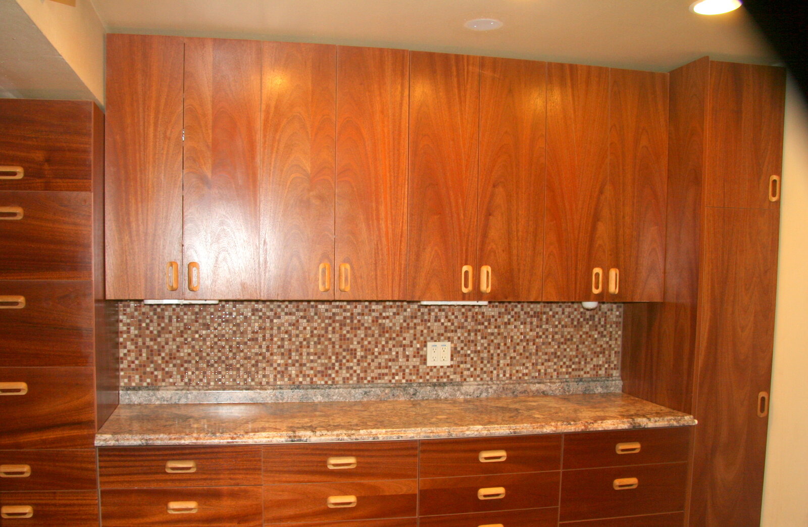

Not bathroom vanity, but my husband built these a few years ago. Seven drawer 24" deep x 24" wide pantry, four double wall cabinest, 4 sets of drawers below (16 drawers), broom closet and tray storage above on the end. All drawers full extension slides. Mahogany plywood, Euro style (no face frames.) Eight foot counter.
