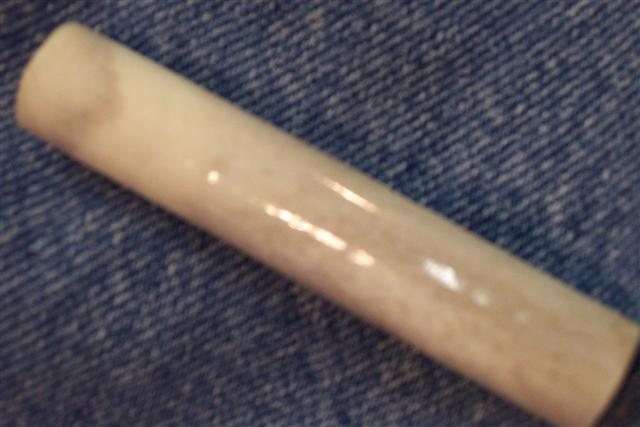

This is a"before section of a piece of antler that had been drilled and roughed for a "long antler pen" I pushed the tube in too far and the CA set before I could reposition it.
I soaked it in acetones and managed to get the tube out and salvaged the blank and tube.
It had a very dull finish and had not been turned or sanded. In this condition it doesn't look too bad.

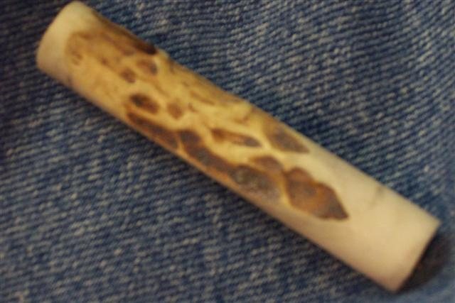

The back side of the same antler

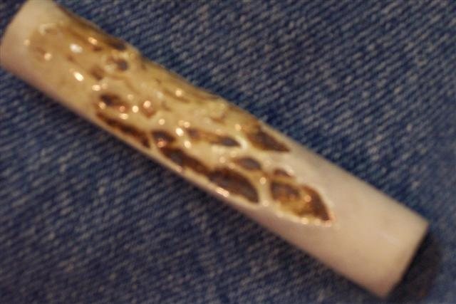

This is the same piece 2 minutes later after buffing with the Dico plastic buffing compound.
(note, it still has not been turned or sanded)

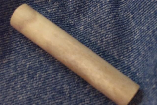

Other side of the same antler,the dark line is where the antler passes through the skull.(This one did a post mortem "shed", surgically removed with my bandsaw.)
I would like to reiterate, there is no CA or any other type of "finish medium" on this antler other than possibly a small bit of CA from the jar of acetone it had been soaking in.
I let the antler air outside for a day to dry it out.
