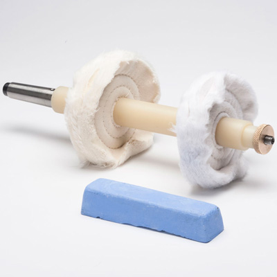

Mine is not the Beall. This is the one I have:
This one uses a blue compound that comes with it and last quite a while (I bought an extra, and 2 years later still have half of the original...) and it has an MT2 taper, so you just pop out your mandrel, center or chuck, pop this in, tighten your headstock and buff away. If you use a mandrel, you can buff your pens without taking it off, I turn between centers, so I just use a long bolt inside the tube to help hold it so it doesn't fly across the room... Can't say what speed I buff at, my lathe is not variable, and it pretty much stays on the middle belts for both turning, sanding, finishing, and buffing. It goes to the slowest speed for drilling.
Someone (PSI maybe, I don't remember) sells a 3 wheel version, but I believe that is more for wood finishes, not CA or acrylics...
The 3 wheel Beall did not fit on my mini-lathe...
Thanks for posting that pic, Todd. Looks like just what I need. If you can remember where you bought it, please let me know. What size are the wheels .... 6" ? 8" ? Hmmm .... maybe even 4" if that is the system from CSUSA.
I bought mine at a wood show event that Arizona Silhouette was at as a vendor, it's branded as Barry Gross's, and it is the same as the one CSUSA, Arizona Silhouette, and probably several others sell. I believe they are 4 inch wheels, and for pens I don't see any need for anything larger...
