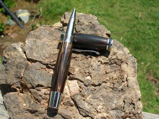

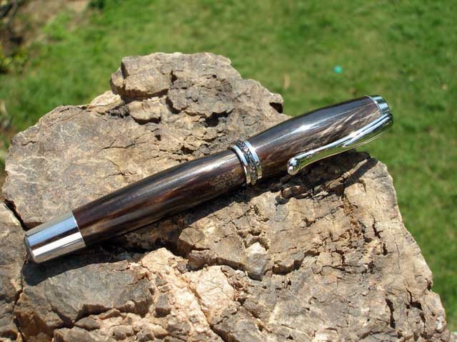

Here is my first experience with buffalo horn. Not bad, tends to crack and splinter a bit while turning it. The blank I got from a friend, and to do the statesman, I had to drill on the lathe using 25mm jaws to hold the blank, so I could ensure I got dead center. Even then, it was a hold-your-breath type drilling. I think he said he got the blank from PSI, it was one of the pre-rounded ones. No room for error when drilling this stuff, that's for sure. I'm actually in a dilemna, I turned this for a craft show next weekend, but now I don't know if I want to part with it!! Anyway, comments/critiques welcome.
Beautiful pen. I vote keep it and watch for cracks for a couple months. This is another material that can crack long after the turning is finished. I hope it works out well for you whether you decide to keep it or sell it.

Does that happen often? I know it tended to splinter while I was turning, but some CA filled the gaps and that was all it took. I wet sanded klingspore to 1500, then went back with 3600-12000 MM. I hit it with some plastic polish, and that was that. I am going to put it up for sale at the craft show next weekend, but if it doesn't sell, I'll probably keep it as a personal. Thanks for the heads up.
