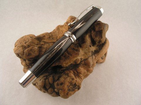

Jeff here is one of my Buffalo horn Barons, black with light grey streaks.
<br />
Beware of the smell when turning![xx(]

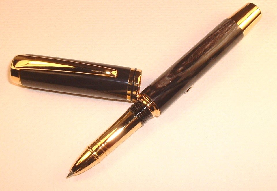

<br />Can I see you pen Ed?
Not today, in other shirt pocket.
Will take pic this weekend and post on Monday. (If I remember, 2 day show this weekend, too).[:D][8]
Oh yea, that is sweet! It was not sounding like it was worth the hassle, but sure looks like it's worth the problems. Thanks Mark. And Ed..sure I'd still love to see yours too. Gives some comparison in look and likely a different kit too I'm sure. Look at the shine on that thing! I like deer antler, but it sure doesn't shine like that!

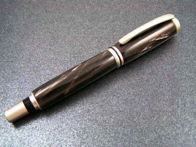

Here's a picture of a Jr Statesman I did in Buffalo horn
