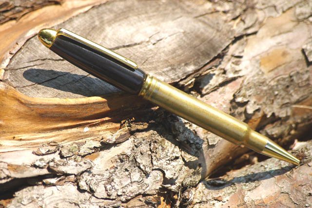

I made this from stabilized buffalo horn and a .340 Weatherby Magnum Casing and actually sent it to Roy Weatherby Jr. I had no problems with cracking but it does smell terrible. It will stay with you for days.
