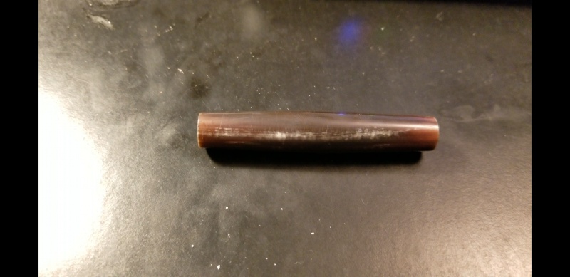

I tired my first buffalo horn and something is wrong. I turned to pen and had a grey shaded area on the pen in addition to being more brown. Not the deep black I was expecting. I was seeing primarily ribbons (1 inch long) without any chatter when turning.
I tried sanding it down but did not have any luck. I then took it all the way up the micro mesh to really see the blemishes for this post.
Any thoughts? I am new to pen making and this this my first attempt at a non wood pen.

Those kinds of colors are common in horn.
Routine run blanks will commonly have streaks with different shades and tones.
Water buffalo also has a habit of cracking so give it time to cure and balance stresses before assembly.
You are tackling one of the most challenging materials for pen turning, in my opinion.
I know that my statement is not offering you any help.
I have had water buffalo work without cracking, but it needs to set between each phase. It takes time to lose moisture and relieve stresses. Letting it set for a month or more between operations makes a difference.
Want a fast pen, turn acrylics.
