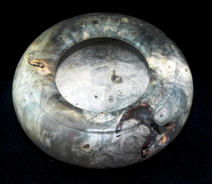

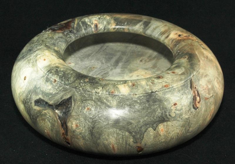

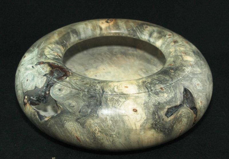

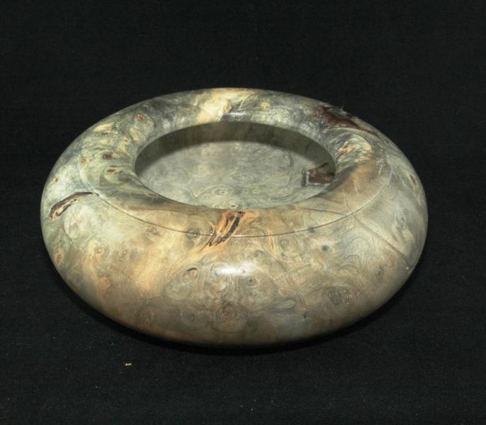

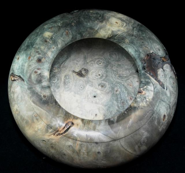

This was today's project
10" wide by 4.5" tall
The wall thickness is 1/4"
I have only taken it to the final sanding finish
I am still debating on the finish that I apply to the bowl.
I am considering Walnut Oil
Natural - good shine - plus it is one of the oils that will actually harden after multiple layers.
I would love to get some finish suggestions
I am always looking for the "Perfect" finish
Comments welcome and encouraged.
Thanks
Kevin

Beautiful job on this one Kevin. I love Buckeye Burl and have to admit, this is the first bowl I've seen. I think a satin finish would look good on this so the wood is the focal point not the finish. I've done a Deft satin lacquer finish on some of the stuff I've done, doesn't change the color of the wood and gives a nice soft finish.
Nicely done, Kevin. The form is a little non-traditional, but it does a great job of showing off that beautiful burl. That's a knockout piece of wood you started with.
As for the finish, I tend to use shellac for an initial coat especially on soft woods like buckeye... It helps me build the final finish faster than just using a penetrating finish like oil. For me, the WOP is hard to beat for a quick and easy finish, but I wouldn't argue against a nice satin oil finish.

I should have included a straight on side view photo - The photos listed don't show the bowls true shape - I will try to add a couple
These pics make it look fat and stubby ...LOL

I turn a lot of buckeye burl and often use spray lacquer due to the irregular shape in many of the pieces left by the voids in the burl.
One concern with using walnut oil is that i find it darkens the piece quite a bit and can even change the color ....which is not a bad thing always but I have never used it on buckeye since i would be afraid of losing the beautiful natural colors.
just a thought

I've used Formby's tung oil on the few bowls I've done so far. It doesn't darken very much at all, penetrates well, and I don't have any problems with the finall coats drying overnight.
Admission: I haven't tried many of the other finish alternatives yet, so I don't know how they compare.
Dave - Thanks - Thats actually the first thing I tested on a cut off piece!
Wayne - That's an interesting thought - I use straight Marine Spar on my wooden razor handles for waterproofing - I will try your mix on a Cherry Burl Plate I finished yesterday...
I have already started applying Deft Semi Gloss Lacquer - I build up 6 or 7 layers and then work it back down to a smooth shine with Pumice, Tripoli and Rotten
