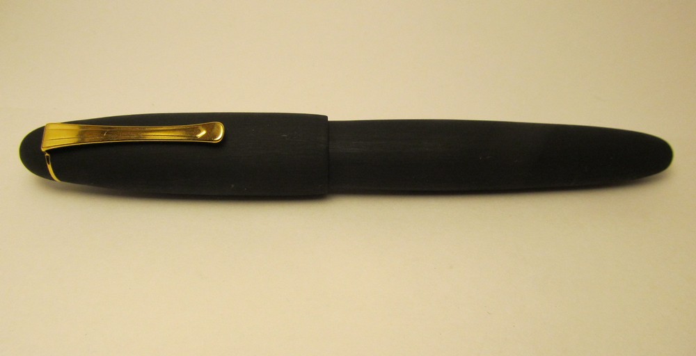

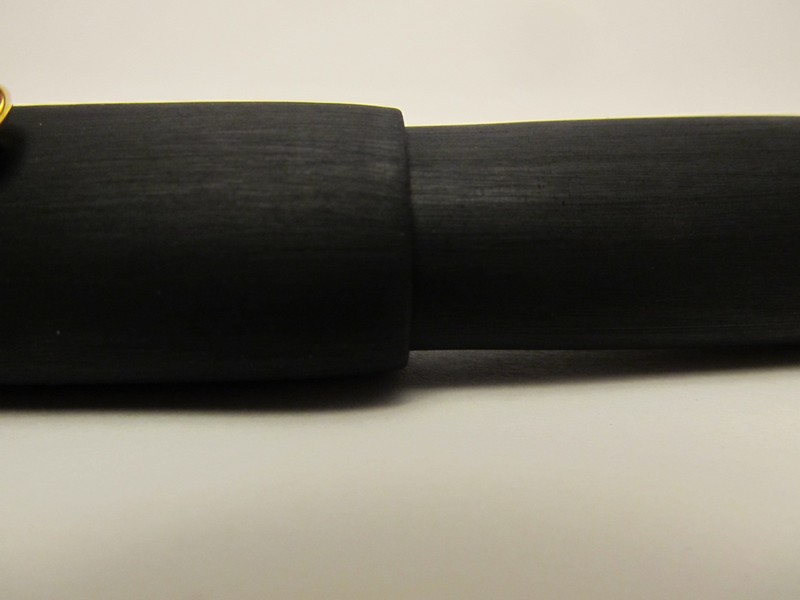

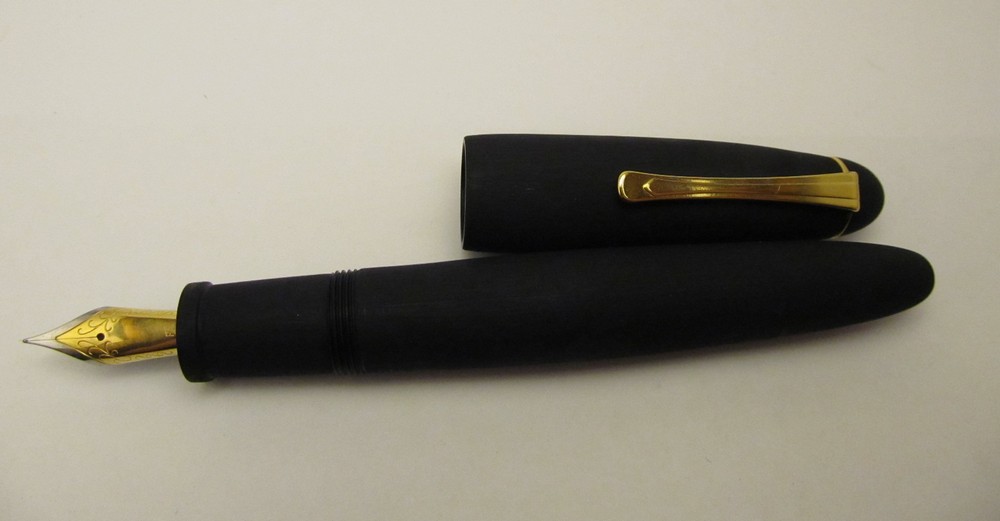

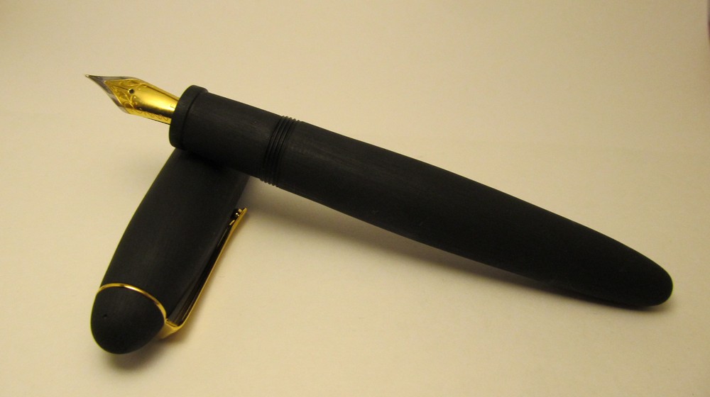

I used some yellow rolled 220 grit sandpaper for this. It has a cloth back and says Made in Germany I think
Made from black ebonite.
Closed 6 1/8 inches – Open 5 1/2 inches – Posted 7 inches.
So yes, it's big. :)

Shawn - Will black start to wear off into your hand after writing with it a while? Also with that finish you may have oxidization problems early.
Now having voiced my concernes, I do like the look of the finish, very tactile looking.
I don't see why it would. I gave it a good bath after the final sanding so it should be good. Shouldn't be any dust left to come off.
As for oxidation - (from different spots on the internet) - * almost all ebonite will oxidize to some extent due to UV, air contact, and handling - * vulcanite and other hard rubber collectibles that have been preserved in darkness have shown no discoloration after 100 years. Even pieces that have begun to oxidize can have the process slowed dramatically by proper storage from light.
* The sunlight and oxidation issue can be a setback, but if taken care of and loved, ebonite pens will last longer than any of us, keeping a great color and finish.
It also depends on the ebonite itself - the quality of it. I'm not sure this finish will cause it to oxidize any quicker. Even if it does - it still might take years and years before it happens if cared for properly.
