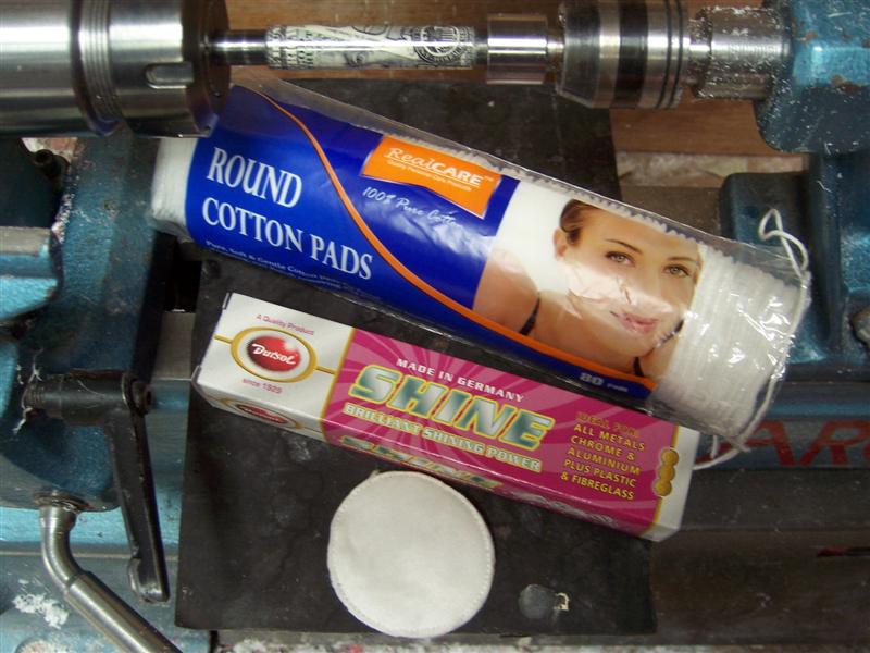

Shine and cotton pads is the best i've used on brass and all Metals
and plastics.
