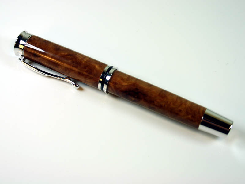

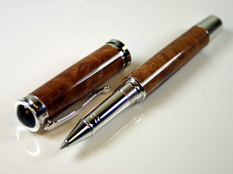

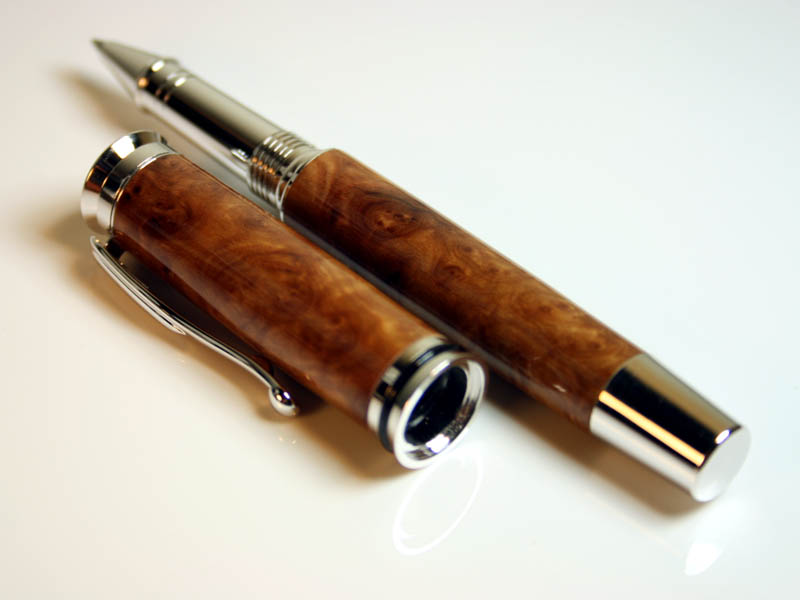

This is a JR Victor Rollerball (aka JR Retro) in Brown Mallee.
Sanded to 400 grit. CA Finish - 20 thin coats. Sanded to 2,000 grit. Brasso, cornflour then automotive wax.
Thanks in advance for any comment or suggestions for improvements.
Regards
Timberbits.

Very nice pen, fit and finish is great. On the photo, it looks like you need a little more depth of field in your focus. The best way I know of to achieve this is to add more light so a smaller aperature will be possible (at a given shutter speed). If your camera allows manual settings, choose the highest f-stop it will allow and everything should be in focus.
I'm offering this assuming you wanted everything in focus. If not, never mind :smile:.
John

Thanks everyone for the kind words on this pen that I have made.
Extra thanks to John for the advice. I was getting lazy by not fully setting up all my lights and not using a tripod. I will do that next time to increase my depth of field.
Regards
Timberbits.
Another beautiful bit of timber David . You guys from OZ are lucky to have some of the most beautiful woods in the world . The LOML just got me a box of Corn flour (starch) for the next pen I make . Thanks for the tip .
Don't mix too large a batch at a time, after about a week the slurry starts to smell like rotten eggs.
Hope it helps.
Timberbits.
