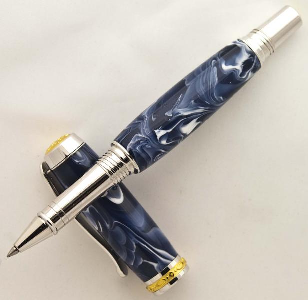

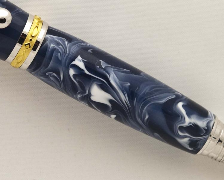

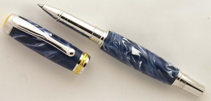

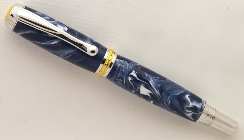

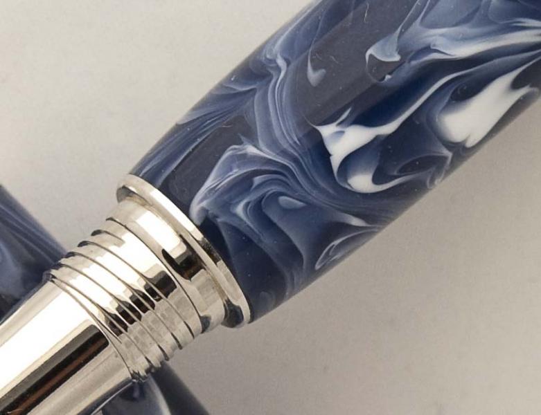

Made it this A.M. I haven't turned anything in several days..so this was a really nice morning. I turned one of Jonathon's (Brooks803) blanks I got yesterday...it's the first one of his that I've worked with. It's on a 22k/Rhodium Jr. Statesman Rollerball. After taking the pictures and looking at them for a while..I don't think I did his blank justice with the reverse painting or the photos but I tried and it was practice. I didn't have violet Ceramcoat to reverse paint with so I mixed colors to come up with something that had some resemblance to violet. I think the color I applied was a little too white and blue. I used chameleon tubes from CSUSA made for the Jr. Statesman. Fun to turn...not chippy at all. Sanded to 600 grit, MM to 12000 followed by HUT plastic polish. I took two closeup shots but I had a heck of a time keeping dust off the surface..probably static buildup. If I had to do it again, I would have waited and gotten violet Ceramcoat and gotten better pictures.:rolleyes:. Hope you like it anyway. Comments are welcome but most of all thanks for looking. Doc:smile:

I like it!! Fit is good.
I have a couple of these to do next, I have never done these before so I'm now really looking forward to doing them after seeing your's :wink:

Wild...! I really love the blanks Jonathon comes up with and I'm looking forward to seeing the ones he comes up with for me when time allows. I still have about 10 days left here in Germany before we head back and then it's a wait for our house before I can turn again. Can't wait! Anyways, this is a bautiful pen Doc and you did a great job with the blank even if you think it could have been better with the other paint. A real beauty...Thanks for showing her

Doc, always good taste in blanks!
Personally, I think the gold on that particular kit clashes and takes away from the blank. I wonder how the eyes would react to a pure rhodium or chrome plated kit with nothing to take from the blank.
If I flash that blank onto the screen, I always focus in on the band, before I notice the blank.

Alan, I think you are right! In retrospect...that is what I would have like to have done. I noticed Jonathon also put some of beautiful blanks on Rhodium components. Regards, Doc
That's a fine looking pen. It's hard to get vibrant colors mixing Ceramcoat, because the primaries themselves are not very pure in chroma. On the other hand, you arrived at a very nice muted color for this pen, which suits it well.

Another great looking pen Doc! I think that you did great mixing the paints..accents the color and depth of Jonathon's blanks wonderfully! LOL before you know it, you will be treating us with your artistic talents by doing some true reverse painting!:biggrin:

Wow that is an awesome blank! You did a good job picking out the kit and putting it all together Doc! I think it looks really good. A lady I know at work would LOVE a pen like that one. I will have to keep my eyes opened for when more of those blanks come up. Good job!

Not knowing how the blank looks before drilling and turning, I'd say it still looks gorgeous! I did not appear to have any weird color tones to me. Nice work doc!
