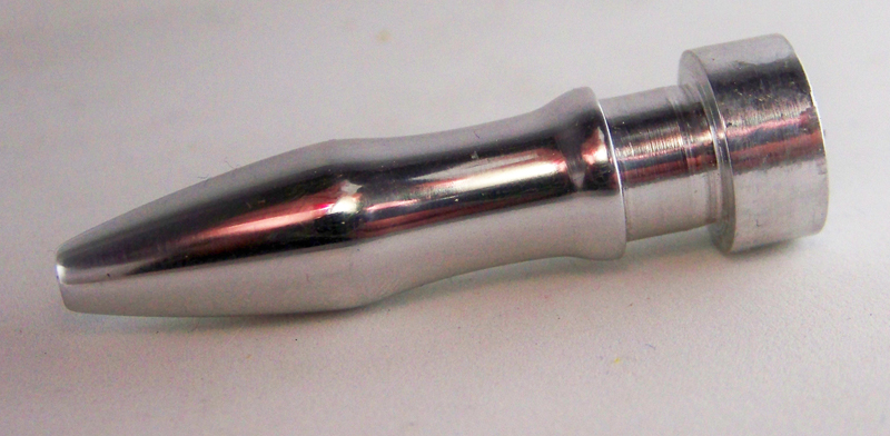

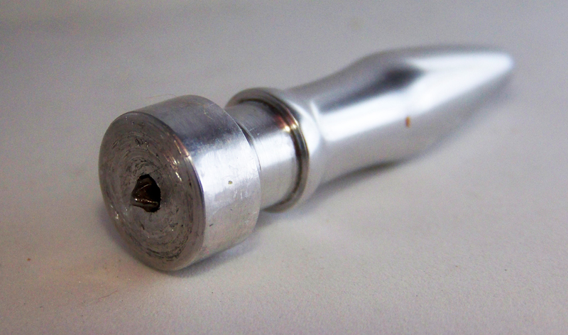

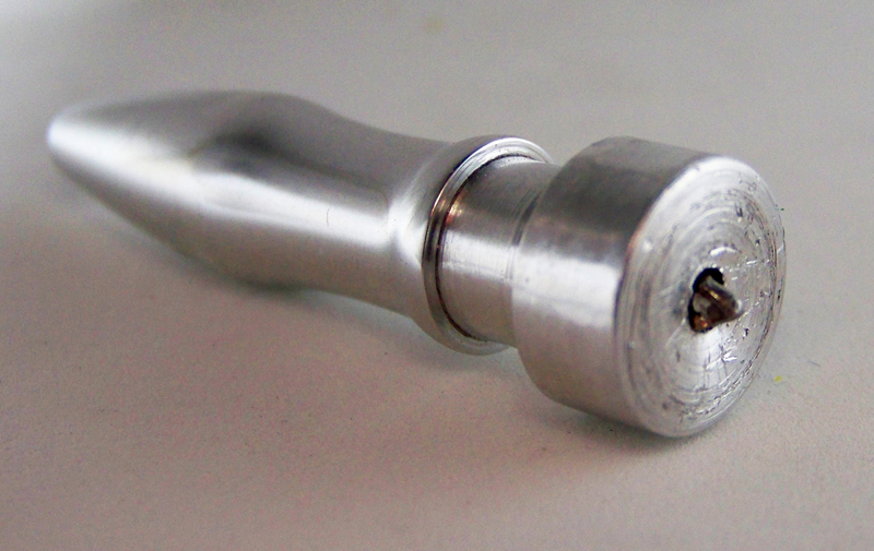

for the pen I made for my 1000th post I had made this nib to attempt a fully kitless pen. Well...in drilling out the backside of the nib to allow the refill to fit properly the bit broke off inside. I didn't clear out the bit as I should have but now faced with this. The nib has been completely drilled through but it's in there good and tight. I was looking to see if the expertise of my fellow IAP members could help salvage this peice. Here's a link Pete (Curly) gave me: http://www.chaski.org/homemachinist/viewtopic.php?f=4&t=89129. Before I go out looking for this stuff I wanted to see if there was a more simple way first. I know just starting over is the easiest way but I like how this came out so I want to try to fix it first before putting it on the ever growing "dummy, why did ya do that" table to remind me of past mistakes. Thanks in advance for any assistance!

How much is in there?
Based on the picture, I assume you still have to trim off the end where the drill bit is ... can you carefully cut this off and expose more of the bit so you can get a hold of it so it could be twisted out? Or maybe you'll get lucky and have it come out with the trimmed piece.
Put it in a frame and hang it above your lathe as a reminder. When they're in tight like that I've never been able to salvage the piece.
Right, the part the bit is poking out of will be cut off. I'm used it to hold the peice in my collet chuck. The bit is probably 1/3 the way in there.
You cant grab the protruding piece with vice-grips?
Tom
I tried that already. That's what all the tool marks are on the back of the peice.
I'd say put it back in your lathe, and cut off the section taking light cuts until you are though the aluminum and expose the drill bit (the tip should stay stuck on the drill bit) ... you should then be able to twice the bit of aluminum off and expose enough of the drill bit to be able to attach vise grips or similar to it, then just twist her out (hopefully at least)!
