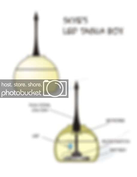

Ok, here's my idea. I think it would be a great little desk item, I really wanted to do it before I let the cat out of the bag but I know it'll be a month till I get the time to do it myself. So, maybe someone else can get it done.
The idea is a small, thin walled, tagua (because it's so natural looking) box, push button finial. The finial will slide (no glue) loosely into the top which will have a long drilled guide hole.
The finial extends inside the box and hits a microswitch. The microswitch is attached to a battery and a bright white LED. There will need to be a small retainer (like a washer made from wood) that will get glued to the finial. That way you can lift the finial without it coming out, letting the top pop off like it's supposed to.
Here's a pic of my box, then a drawing showing what I'm thinking about:

If this idea catches on, nobody will be able to get my nuts out of their minds. I think they would be a neat show piece, maybe set up a little box for them so they glow at shows. I just need to learn what kind of LED/battery/switch combo to use.
Here's a thought.......
If you can find a normally close micro switch, then you could use a small rare earth magnet in the lid. With the lid on, it would open the micro switch thus turning the LED off.......lift the lid and the micro switch closes and lights the LED. Would be much simpler!!!

Titan: that may work. I'm not sure how storing it in two pieces when not in use would go seeing how it's not going to be pretty inside and it'll be unlit more often than lit more than likely.

I would probably use a small magnetic reed switch, and place a magnet on the plunger. When the magent comes close to the reed switch, it turns on. Just make sure your battery doesn't exceed the MAX current of the LED, otherwise the life of the LED will be measured in minutes instead of years. Most LEDs also have a minimum forward voltage in order to activate also, so the actual voltage might be three coin size batteries with a small resistor. Again, this depends on the LED, as most are different.
Ohm's law states that resistance equals voltage divided by current . Most LED'S draw about 20 milliamps so then with 2 1.5v button cells you will need to use a 150 ohm resistor to limit the curent to the LED . Check the package that your LED comes in and they will tell you how much current they draw at what voltage . The above numbers will work with most LEDs but use at your own risk
As Butch mentioned, you want to pick a current based on the LED spec, probably something at the higher end, and 20mA as he mentioned is a common value that works well. Then you need to find the voltage drop across the LED, that will be in the spec. Now you take the voltage from your batteries, MINUS the voltage drop of your LED, and that's the voltage you use to calculate the resistor using ohm's law (V=IR, or in this case R=V/I, with R being your resistor value, V being the delta between your battery voltage and your led voltage drop, and I being your desired current).
A 150 Ohm resistor will certainly work, but if you really want to drive 20mA off a 3V source into a typical LED you'll need a considerably smaller resistor.
Are you looking for an on/off by pushing the finial, or simply on by placing the cap in place? There have been lots of ideas regarding the simple on, but a quick perusal of a digikey catalogue might yield the microswitch you need for an on/off pushbutton from the finial.
