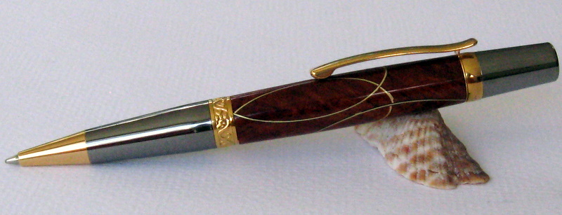

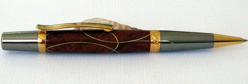

Hadn't done one of these in a long time. Still having trouble exiting the blank with the blade so the joints will line up. Still a good way to spend some time.:biggrin: I believe the wood is Jarrah Burl. Maybe Mike Kennedy will confirm or correct me if I'm wrong. (I bought the blank from Mike):wink:
CA, 400 & 600 wet, Novus II , Maguires PlastX & Ren Wax. Thanks for looking!

Chuck it looks like Jarrah to me. I have never tried the scroll saw segmenting like that yet so I cannot help on the alignment. The pen looks darn good though.

Not a dream,but he was making a celtic knot. This was done by a scroll saw im sure, bandsaw at the least, and has nice sweeping lines. You wont be able to do that with a jig. This is all hand work.

Beautiful pen! Looks very elegant and swirly, and the finish is like glass!
Thanks Angela, I was impressed with this design when David Washburn made one at our local chapter meeting. The finish is the easy part:biggrin:

Thanks Mike, I cut these on a 10" bandsaw with a 5/16" blade. Barely makes the turn. I promised myself I would get a 1/4" blade but, haven't yet.

I have tried to cut these on a scrollsaw in the past. But, the blade grabbed the blank and bounced it up & down and ended up a mess. I do much better with the bandsaw. It's a Marine Corps bandsaw:biggrin: (inside joke there) Thank you for the compliment!

:biggrin: I can handle the big tools! I just remembered, a guy near Zionsville was going to give me some scrollsaw blades. But, he's pretty busy. Anyway, I don't have to worry about the scrollsaw anymore. It takes alot of skill to operate one of those things. My hat's off to those who possess such skills.:wink: YES, I thought about the NOT cutting all the way thru the blank approach. When you cut all the way thru the blank, this allows you to sand each piece smooth so, you can spread the glue evenly when gluing the metal to the wood/acrylic pieces. After drying, sand the sides smooth then rotate the blank to cut the other side.
Part of the allignment problem can be caused by the brass filler material is not as wide as the kerf on your blade you are using. YOu might take a mic and check to see if you havent already done that.

Still looks better than I could do. BTW, they make 1/8" bandsaw blades too.
Thanks Mike, I didn't see anything smaller than 5/16 I'll have to look a little closer next time I order, which will be soon as I need to keep a couple on hand.:redface:

Thanks Mike, the brass IS thinner than the blade but, I didn't think that would affect the orientation of the pattern. But, guess I'll have to live with it 'til this sheet is gone. Thanks for the suggestion.

I just wanted to 2nd what mredburn(Mike) said. Whatever material thickness you cut out, you will have to replace with the same thickness.
I learned this in making rod handles.

I appreciate the comment. Better to have material too small than too thick. Thanks.
