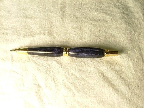

now not every thing about this set up was working. but for the pourpose of this post it does show the effect of bracketing or overexposing for a dark object. in this first photo you can see the texture and wrinkles in teh background material. (a paper towel but background material sounds much more interesting) while the pen looks nearly black. in fact there is only a litle highlight onthe upper barrel that really shows any color at all. great background exposure, stinks for what I wanted a picture of

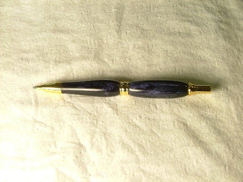

Look carefully at this photo and compare the details of it to the previous one. the light at teh botom left corner gets brighter. the shadows seem to be darker int eh background material, but what has actually hapened is the bright spots are brighter. and the color of the pen is starting to come out more. this is what I am looking for. I could care less what happens to the background as you will see later.
What I have done here is set my camera to expose the picture a half step more than it thinks it should be. if the camera red that the picture shoudl be taken at a shudder speed of 1/1000th of a second it will actually take it at 1/750th of a second. allowing more light to reach the film. this is why everything starts getting brighter.
next I asked the camera to overexpose by a whole step this means the shutter speed will now be 1/500th of a second allowing twice as much light to reach the film. this does bad things for the bright areas but brings out even more of the detail of my pen as you can see below.

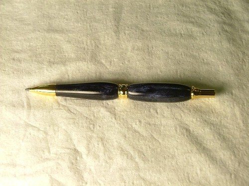

On my particular camera I can ask it to go two full steps overexposed. at this point the bright light at the bottom left actuall completely washes out the nib of the pen.

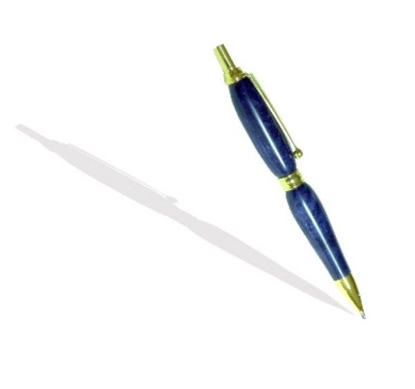

basically you take a picture at reg. over one half, over one, over one and a half. etc then pick the one that ou like the best. in this case I tried several other light configurations to eleminate how bright the bottm corner was getting. put the picture through my editor adn did some massive playing with it. and came up witthis. keep in mind that although this photo was heavely edited it was to erase the background, skew it adn add the shadow. the detail in the color of the pen is from getting the right light set up and bracketing the photo.
