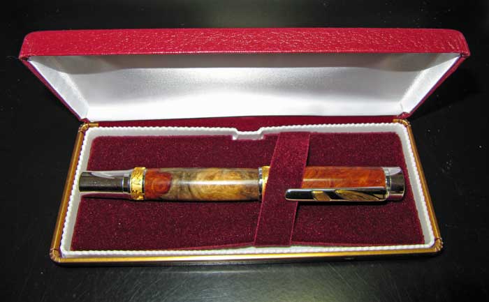

I use the Cabretta box from CSUSA. Black is 50-3100, Burgundy is 50-3110 and they are $3.75. Lau Lau Woods has them cheaper but only in black.
Here is an Imperial in one.
